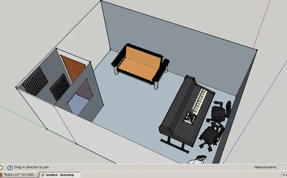

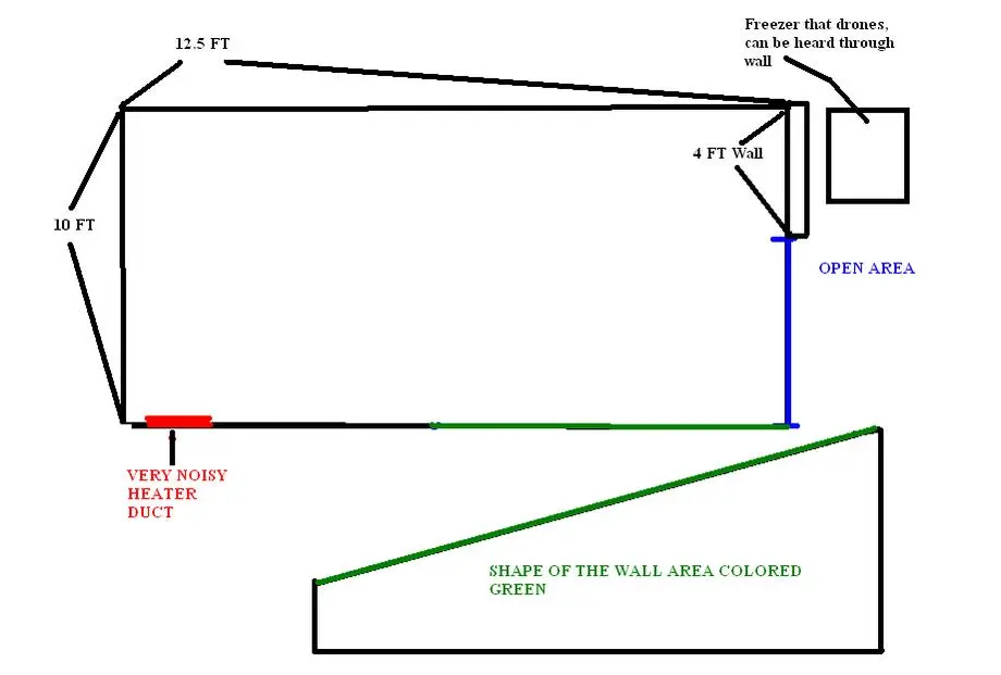

I have an empty room in my basement I am trying to turn into a vocal/beat production room. Due to size constraints I have decided to track vocals and mix in the same room and get rid of the "booth". Here is a MS paint layout of the room. I can take actual pics if needed to help.
The room is 10x12 with a 6.5ft drop ceiling.
The google sketchup was an idea, but I built the booth and found that a vocal booth that small is worthless(the sound sucked, booth was 4ftx4ft), I continued to read that I should also be making broadband absorbers and not buying studio foam, especially from frauds(don't even need to go into this)( TY RealTraps for this knowledge) So I had two costly lessons and spent a lot of time getting no results(live and learn) ( Roughly $300 mistake :( )

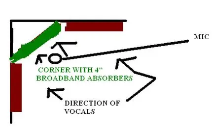

I am asking what direction should I go? Could I keep a corner of the vocal booth and just get rid of 2 walls on the booth and put up 4" broadband panel(ATS, Roxul, 703 etc) on each side, one slanted in the corner? ( shown in MS Paint ) This would kind of be like a 2 sided gobo, but permanently fixed.
My other Idea was to tear everything down and build a gobo. Or keep 2 sides of the old booth and do 2ft modular panels in a half circle shape, so the new "booth" is a cone shape...

Yes take out the Booth and use the whole room start by putting some bass traps up in the corners. Doing the vocals into the corner of a treated room will give a lot better results over the booth
Ok. Looks like this Friday I will be heading to home depot to buy materials to build some 2'x3'x4" frames for some traps. Hopefully they have some mineral wool or something in stock also. This is a valuable lesson learned, and a learning experience. Also I am really not worried about sound proofing the room because It will just be me in the house when recording. Outside of that I have decided the heater duct is mute as in the winter I can turn the heater up a few degrees then shut it off to give me a few hours of work time a day.
I appreciate the help knowing that I am heading in the right direction.
Not a problem If they don't have Mineral I took attic Insulation two bats and compressed them into a 4 inch frame used hardware cloth to hold it in and then covered it worked out fine
Tim
i would flip that desk around so it is facing the opposite way as well so you're not getting bad reflections from right behind you
