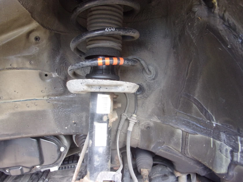

A pleasant surprise rob after removing the wing liner; no rust under it and still with factory rust proofing doing its job.

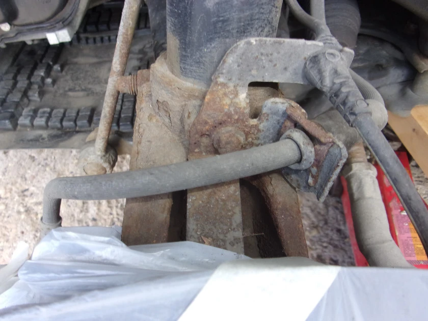

Here's what happens even at seven years old and it needs treating sooner than later before the rust spreads.

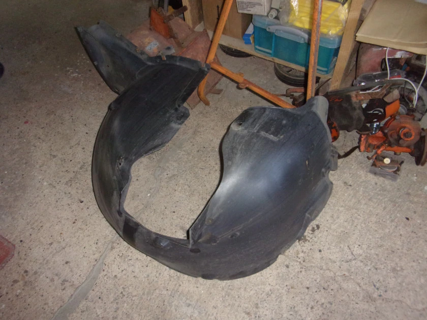

Here's the wing liner which gave me no end of fun removing it having found all nineteen T25 Torx screws and a great deal more fun refitting it.

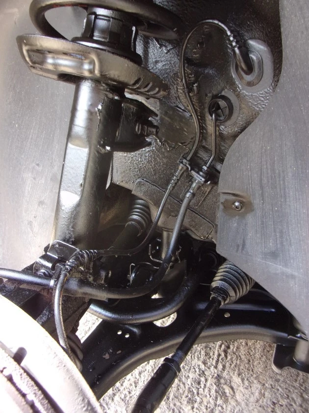

I spent hours on this one wing area today; it's pointless rushing a job like this having spent around £100 on rustproofing materials; I sprayed a lot on using compressor and spray gun but also used a brush to catch areas missed by the spray gun; what a truly dirty job; wire brushes; scrapers and coarse abrasive paper were used to remove loose rust.

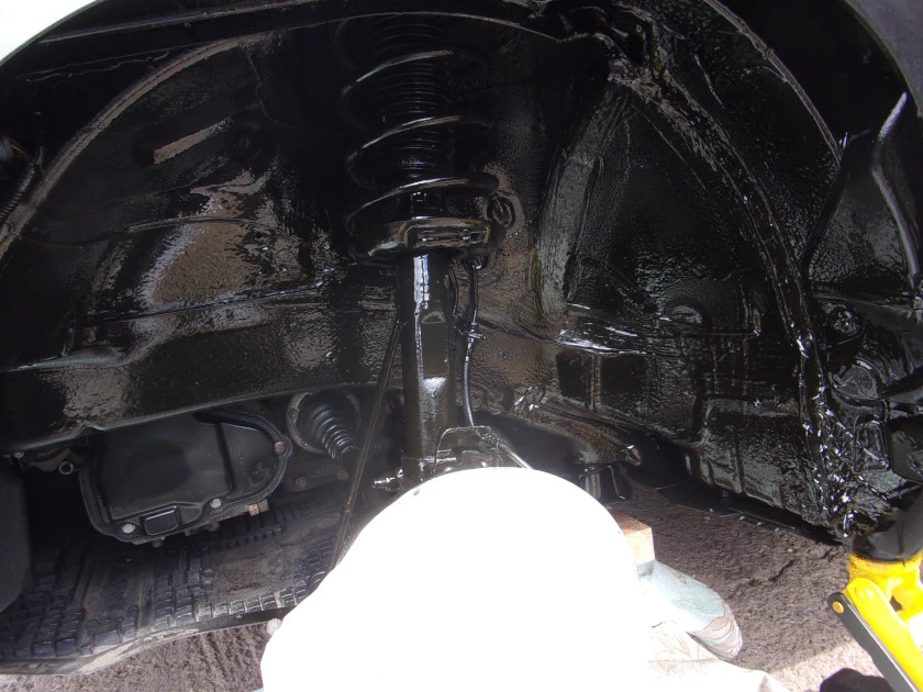

I'm very pleased indeed with the Bilt Hamber; here's one wing completed and liner replaced; three more to go but now I've done one the others should be a lot quicker.
