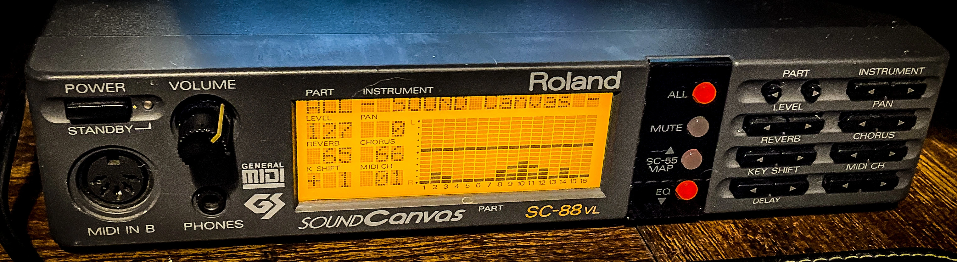

Roland SC88vl general midi sound canvas module

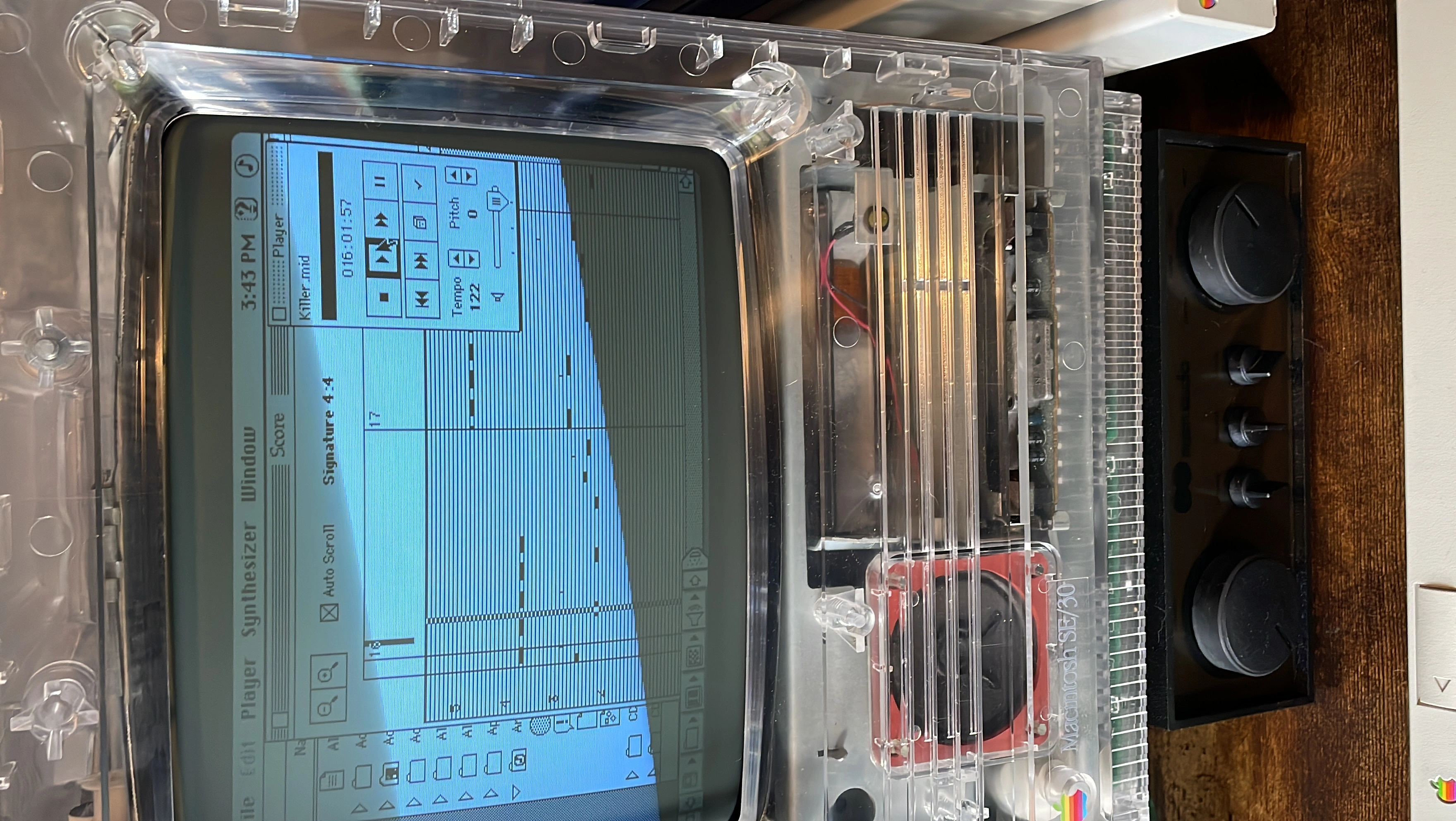

I’ve had a hankering for sometime to setup my 33 year old apple macintosh SE/30 as a vintage recording studio using cubase or some other type of software from the period.
I am though a complete novice to recording studio software and Midi. Probably bitten off more than i can chew but would like to get it working and attempt to use it.
Problem is getting the midi to work, i can now play midi tracks from the computer through the sound canvas midi module but having problems getting the keyboard to work and show up on the computer. Maybe i’ve wired it wrong or misunderstand how cubase works so any help would be appreciated.

How have you got the sound canvas wired? You are presumably driving the Midiman interface from the computer and have the midi out from the interface going into the sound canvas midi in? The keyboard would normally just connect to the Midiman midi in, then in cubase, there is a menu to direct it back out to the midi out. This is how we did our very first cubase lite setup in the college I worked at. That was a very unusual version of Cubase aimed at schools and colleges so it had the usual cubase midi features with the score editor, and you worked mostly with notes on a stave. It was a bit rotten at notation that was not played to the metronome very well, and it looked a real mess.
How is yours wired at the moment?

I have the keyboard going into the in of the midiman box with the serial in/out through modem and printer of the mac, then output of the midiman into the roland sound canvas. I have sound coming and can see the flashing lights for input and output of the midiman. So maybe i’m not selecting the right part of cubase
I wasn’t sure if I should have wired the controller straight to the roland, then output that to the input of the midimac but by the sound of it i’ve wired it correctly just need to look at cubase
Yes - your current wiring is the norm. Macs are often driverless, but as the MIDIMAN pretends to be an RS232 device, there's a good chance the Mac thinks it's a printer.
It's been a while since cubase lite - but I think the input device if the Mac knows it's there should appear in the inspector, screen left, in a drop down in the input section. If it's not there you will need to find a driver.
Hi Rob, thanks again. I have the oms midi driver installed and i have configured the modem & printer serial pass through so it does recognize midi at 1mhz in the output but doesn’t seem to accept the input, maybe i should manually put it at the same 1mhz and give it a try.
Oh and switched apples proprietary networking off so it doesn’t interfere. I have a separate networking card anyway in the pds slot
