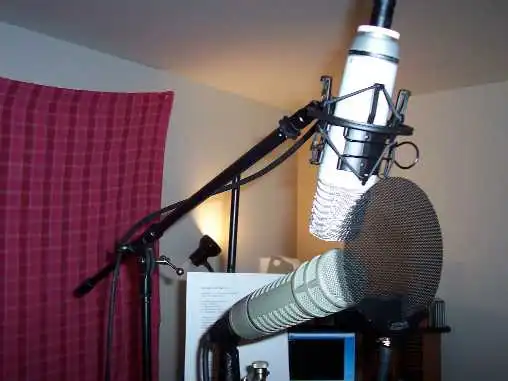

Yep, what David said. I wouldn't recommend doing this often (recording one voice with two mics), as it can get messy in the phasing department, but sometimes it's nice for an effect. I recorded a song that had some spoken passages and singing, so I used an RE20 and a Rode NT1 simultaneously. The results were pretty good. I did have to manually align the wave forms in Cubase, though.
