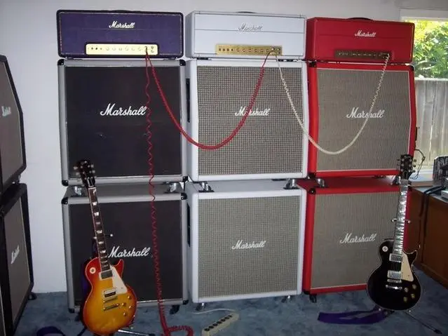

If the amps have two inputs it is simple to get the full power of both.(or more)This does not work on some amps.I used to do this back in the day with a couple of fender twins:
Plug guitar into input one of amp one.Plug one end of a guitar cable into input two of amp one.Plug the other end of guitar cable into input one of amp two.You are done.Crank and enjoy.

It's really not that complicated.Reread my above post and look at the pic below.Done this way you are accessing each preamp and full power section of every amp in the chain.If there is one amp in the chain that has a particular sound you like, crank it up and bring the others in with a little less gain or whatever and shape the E.Q.'s to reinforce it.
BTW, you will have better luck using one hundred watter and one 412.If it is the visual effect of a wall of amps you are after, just roll the others up there and dont plug them in.No one will be the wiser and you will still be on speaking terms with the soundman and your band mates.
