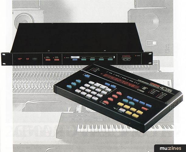

Hello! I have been looking into syncing up my tape machine with my DAW and would like to have the DAW be the master if possible. I was looking into getting a MOTU digital timepiece to connect to my computer, then connect the smpte output of that into a Fostex 4030 master code in. Then set up the tape machine into the slave transport and code in on the 4030.
My main question is does anyone know if the 4030 requires a master transport cable to be connected? It seems it wouldn’t really be needed in this setup but not sure if it would all work without it. Trying not to spend more than I did on my reel just to sync. Any other options or help would be appreciated as this is my first time venturing into synchronizing. Thanks so much!
