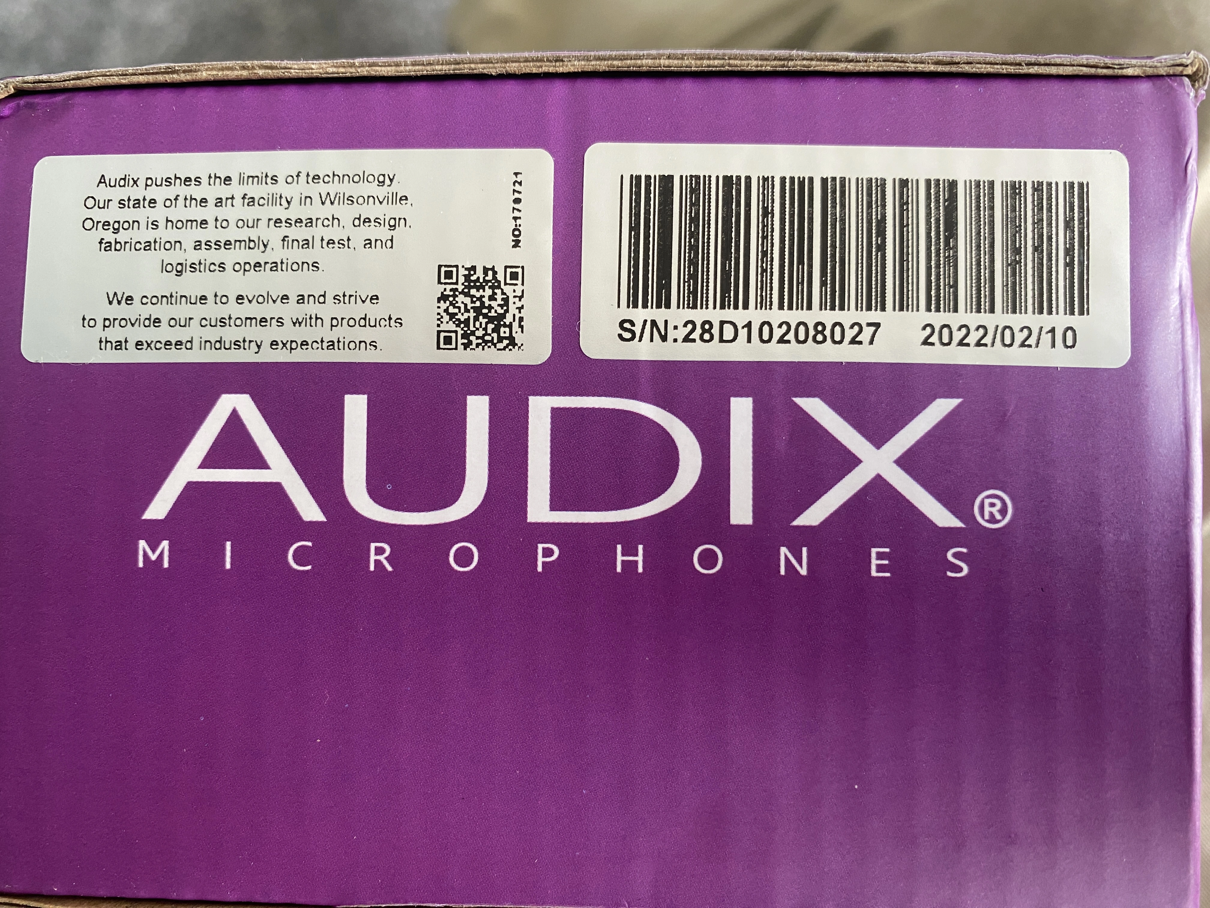

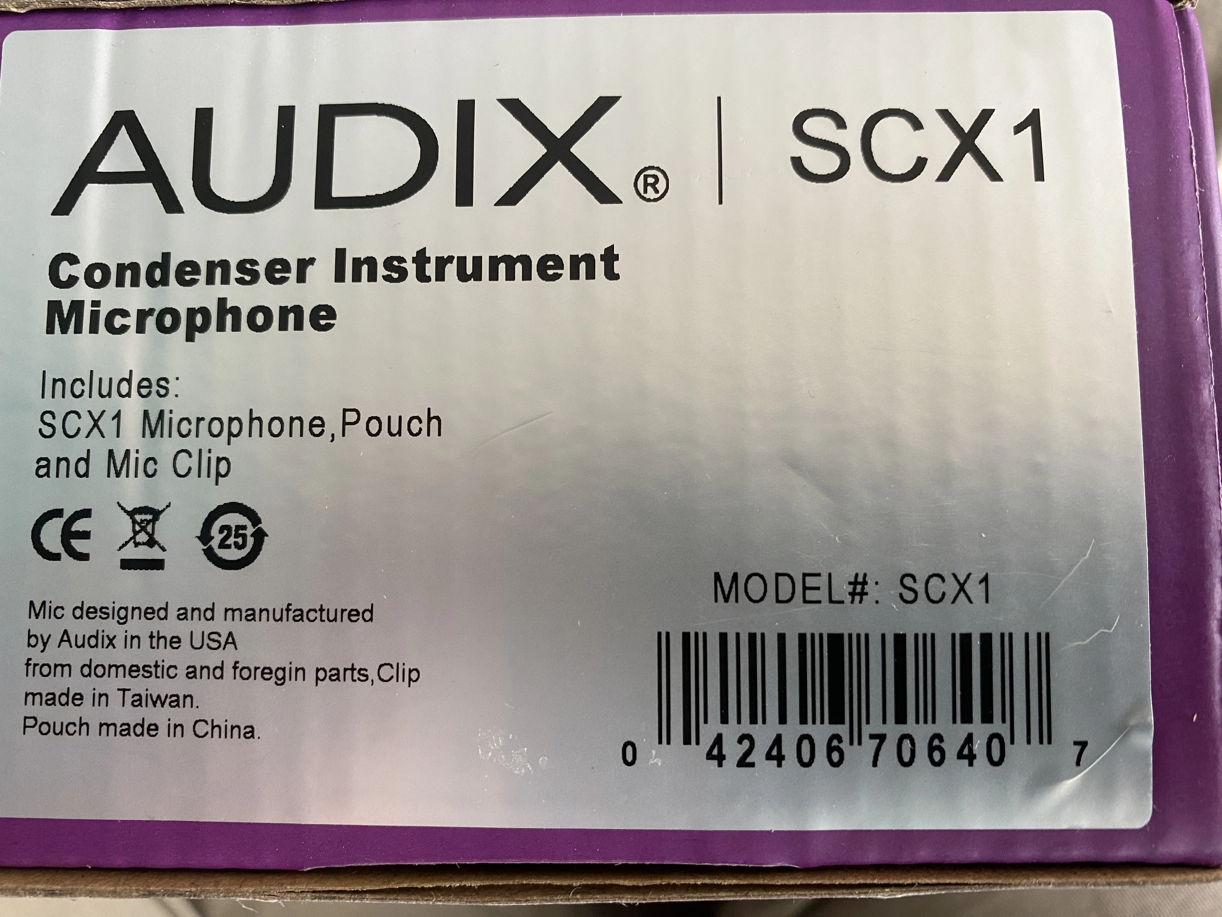

There were little tell tales - and a spelling mistake on the box label was a good one, as they're supposed to be American made, and despite American mangling English (aluminium and using Z's all over the place) they can spell foreign OK - these boxes say 'foregin parts' - but the other giveaway before opening the box is two identical serial numbers and production dates.

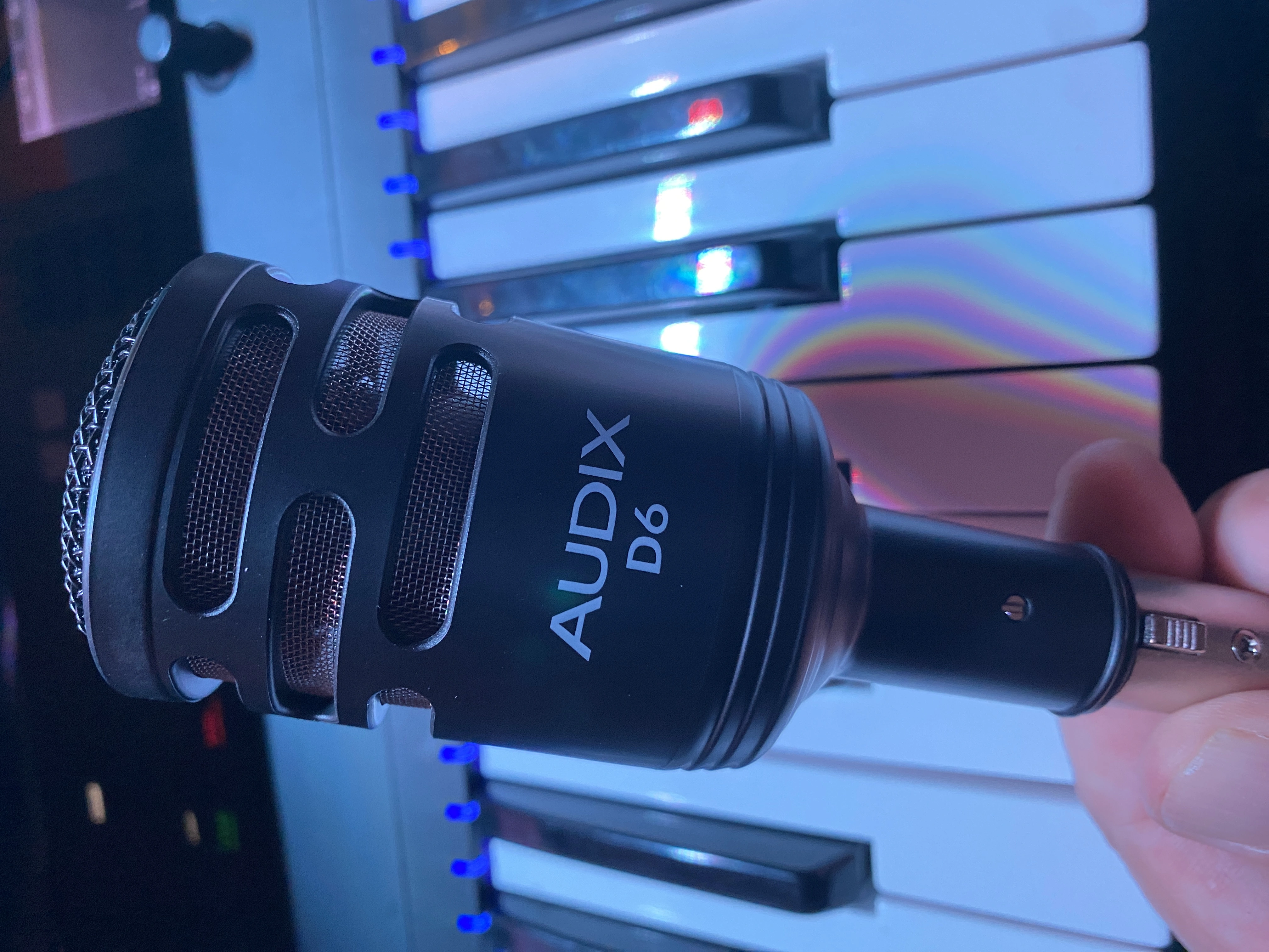

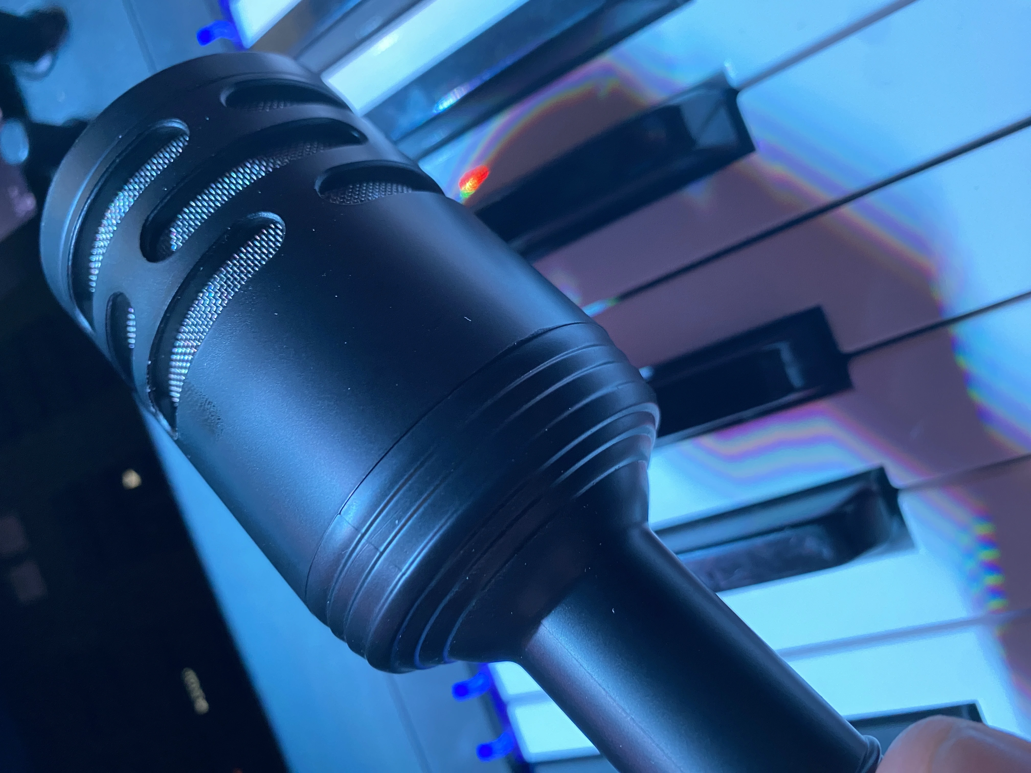

The Audix D6 turned up. It works. It's also plastic , not metal and it is welded shut - no way to look inside. The mould joint marks are quite obvious.
