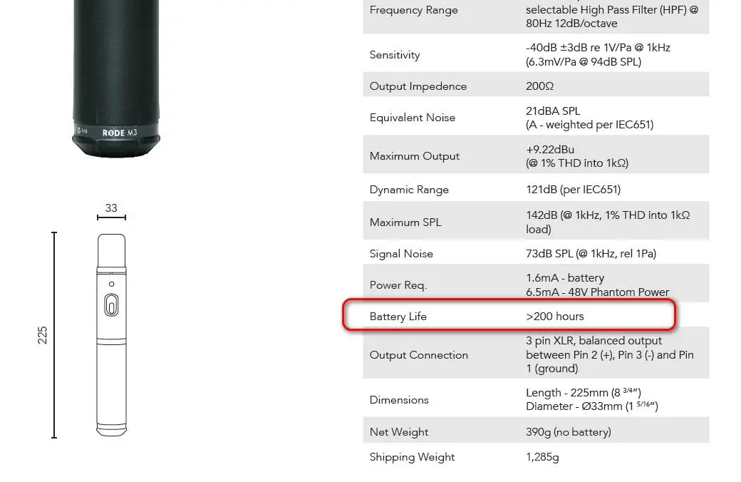

The M3 supposedly has an life expectancy of >200 hrs. 24 hours, 7 days a week is 168 hours. Do you sleep, eat, or work? :) The M3 does have a switch for the battery so it can be turned off when not in use.

Quoted below was in the manual. If for some chance you plan on not using the mic for a while or you get a phantom box, remember to remove the battery. If it leaks as they sometimes do, it will ruin the mic. I have a similar AKG battery powered mic and the battery does last a very long time.
'We recommend that you use a high quality alkaline
battery. Tests have shown a life expectancy for a high
quality alkaline battery used in the M3 to be in excess
of 300 hours. This is roughly the equivalent of 6 hours
usage per week for a year.
