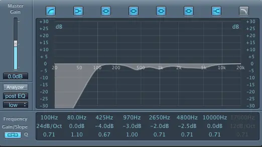

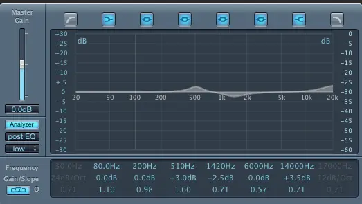

Hi all,
Not sure if this is the right place to post this since it is not a finished mix. That said, for my latest cover I was wondering if anyone can give me guidance on how I can gain more presence to my vocal? I feel pretty good about the vocal takes I've got from the source with this but I feel my voice still lacks presence. Currently I have a compressor, de-esser, reductive eq (picture below), and additive eq (picture below) and have bussed a hard compressed plate reverb and tape delay to try and create presence. Still doesn't seem to be working. What can I do from here? Thanks.

My EQ's
Reductive:

Additive:

I'd definitely work on the vocal performance, i'd say you sound more than nervous. You also sounded more comfortable in the higher ranges. You need solid takes down before worrying about EQ'ing it - but I thought the processing on the vocals was pretty good actually.
