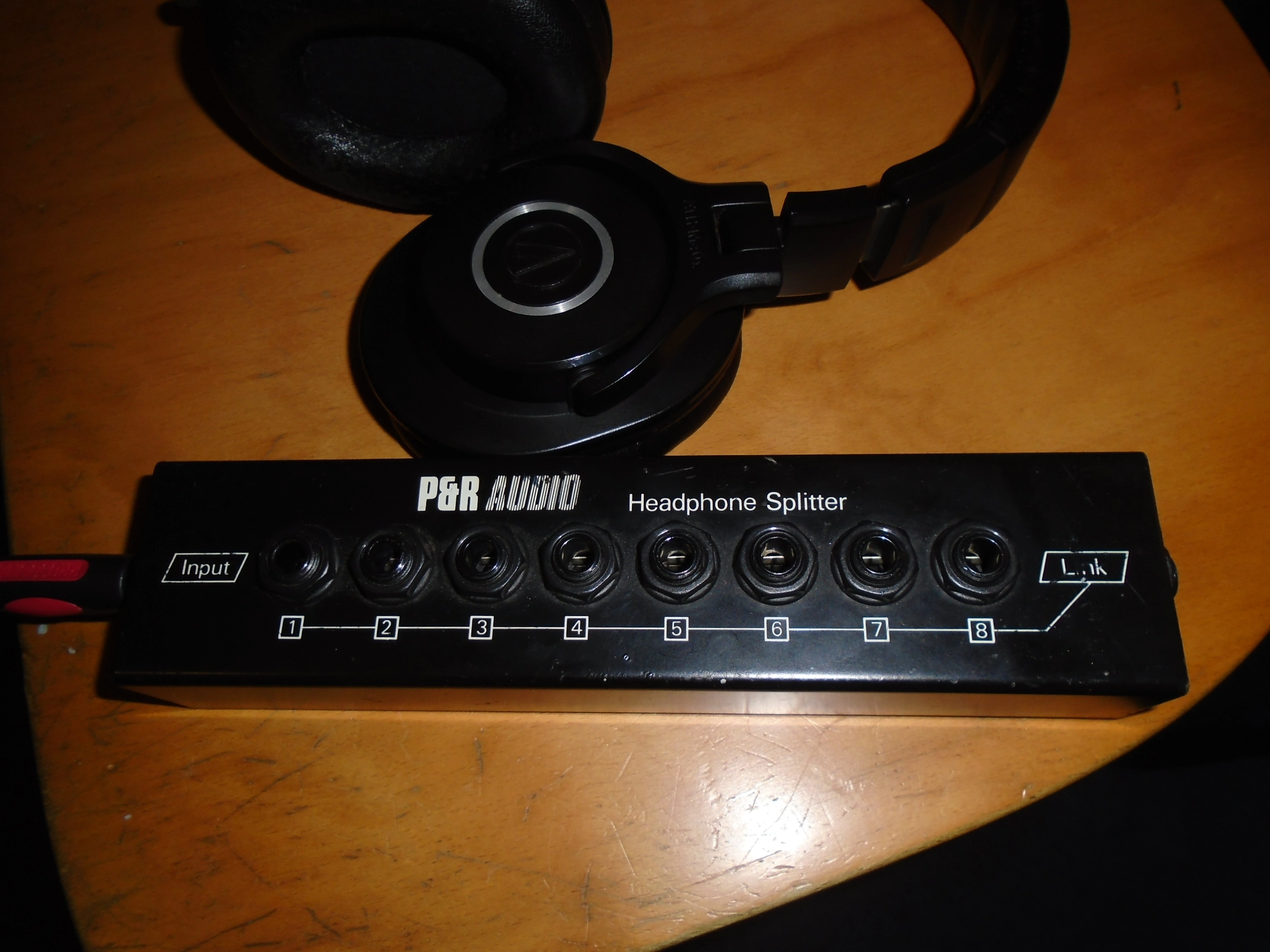

For 29 years I've just used a headphone splitter that has 8 inputs. It has always worked fine. I still use it whenever more than one of us is recording at a time. I don't think they make the particular one I have anymore, it's that ancient !

You strike me as just wanting a simple solution that is cheap and effective, not complex and expensive. If that's the case, just look for one of these type headphone splitters. Like I said, I've been using this since 1992 and tons of different singers and instrumentalists of a huge variety of experience and ability have just gone with it and done the business.
If you need something more complex, I'm not yer man !
A simple cheap headphone splitter can work just fine. Under a dollar LINK Shipping likely $5.
