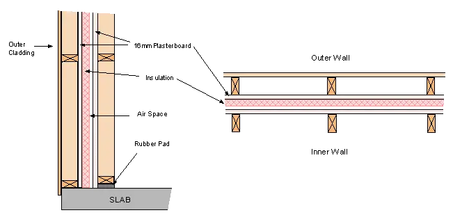

So from there I would build an entire seperate frame with neoprene pads under the studs for the new walls. What to cover with and were to put it is where i'm confused. They sell "sound deadening" board at home depot by me and it's relatively cheap...I was thinking the attached picture would be the best way. If someone could tell me how much airspace to leave between the two walls and also should the sound deadening board be on the other side of the frame or maybe attached to the outer wall and should that be attached to the channeling as well or just screwed or nailed in.
As you'll see in the picture, I was thinking:
There's the exterior wall which is pretty much just 3/4" plywood and a 2x4 frame.
there would be an airspace of 4"?? (is that enough?)
the a layer of sound deadening board attached to the second frame (mounted on pads)
insulation inside the framing
Resilient channel
Drywall
I'm sorry if my terminology is incorrect, Im kinda new to this.
Yes I have people that know about construction, just not studio construction that are helping me.
sorry forgot to attach the picture

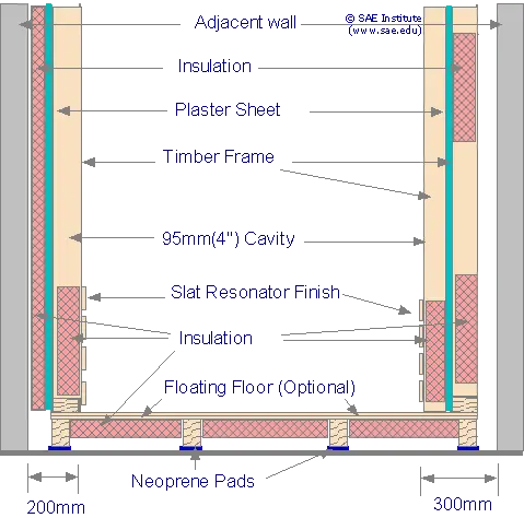

Exec - you might consider building your wall as suggested on the SAE website (see pic.).
The main difference is that the interior wall is not covered with sheetrock but rather slot resonators, fabric covered rigid insulation or just fabric. The advantage is the ability to control the amount of sound energy inside the room as well as what gets out.
Also, in a rectangular shed, consider making at least one of the long walls non-parallel to the other.
Cheers
Kevin.
... Since I only grabbed the picture and not the explanation from the SAE web site, John's wall design is the one on the left.
My appologies
Kevin.

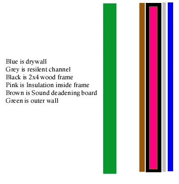

oh yeah once again I forgot the picture....is this what you mean?
Also is that 2" of airspace meaning from outer frame to inner frame?

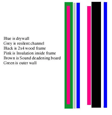

Exec,
I interpreted John's suggestion as being;
Outer cladding (existing)
Stud frame (existing)
Insulation between studs (new)
Resilient channel (new)
Sheetrock (new)
2" Air gap filled with insulation
Drywall (new)
Stud frame (new).
:cool:
That's it ausrock - why 3x2 cos it's cheaper and the walls aren't holding up the world, so they don't need to be goliath :)
cheers
John

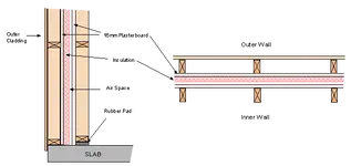

OK through some further investigation on the studio contruction site i came across this attached picture. So the only thing I should change is more insulation inside the outer frame as well.
Oh yeah and can someone tell me where to buy neoprene padding and resilient channeling in the US
Yes you will end up looking at the studs but you now have a cavity for internal acoustic treatment. Otherwise you will end up with a plaster walled room which will need treatment that will takeup extra wall space. The advantage of my system is that you won't loose anymore room space to do this.
You can now put insulation (rigid fibreglass or similar) in the cavity and covered with cloth for high frequency absorption, or you can put slots over the cavity for low-mid absorption, or plywood panels for low frequency absorption PLUS you have not lost any more room space. :)
check out Left Bank at Studios Under Construction where this technique was used.
cheers
John
