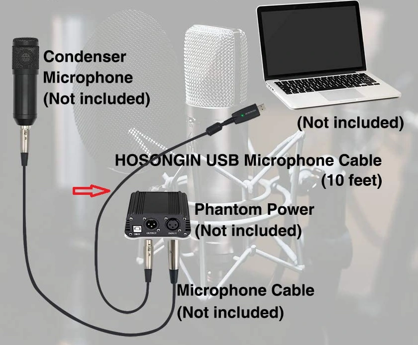

Yeah.. you can use the ZY-007 package from Amazon, just don't use the cables that come with it (the XLR to IEC). That Neewer 48V Phantom Supply will work, but you'll need an XLR to USB to connect it to your computer Amazon.com: USB Microphone Cable 10Ft, HOSONGIN USB Male to XLR Female Mic Link Converter Cable Studio Audio Cable Connector Cords Adapter for Microphones or Recording: Musical Instruments
But.. as [MENTION=190964]arcaxis[/MENTION] has pointed out, you'd be better off going with one of those interfaces (plus an XLR female to XLR male mic cable).
This will give you good volume and virtually zero noise.
