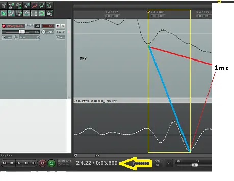

This thread got me checking my Latency on Guitar Dry T1 & running through PodFarm FX and AmpSim stereo T2....its 1ms between the two per the waveform/timestamp. This is an old Line6UX8 interface on a cheap pc Windows 10.
Driver operating at 44100/32bit and buffer 512 / bit depth 24. I dont really do anything fancy but I also record one thing at a time here in HR land...not doing 12 drum mics or anything.
