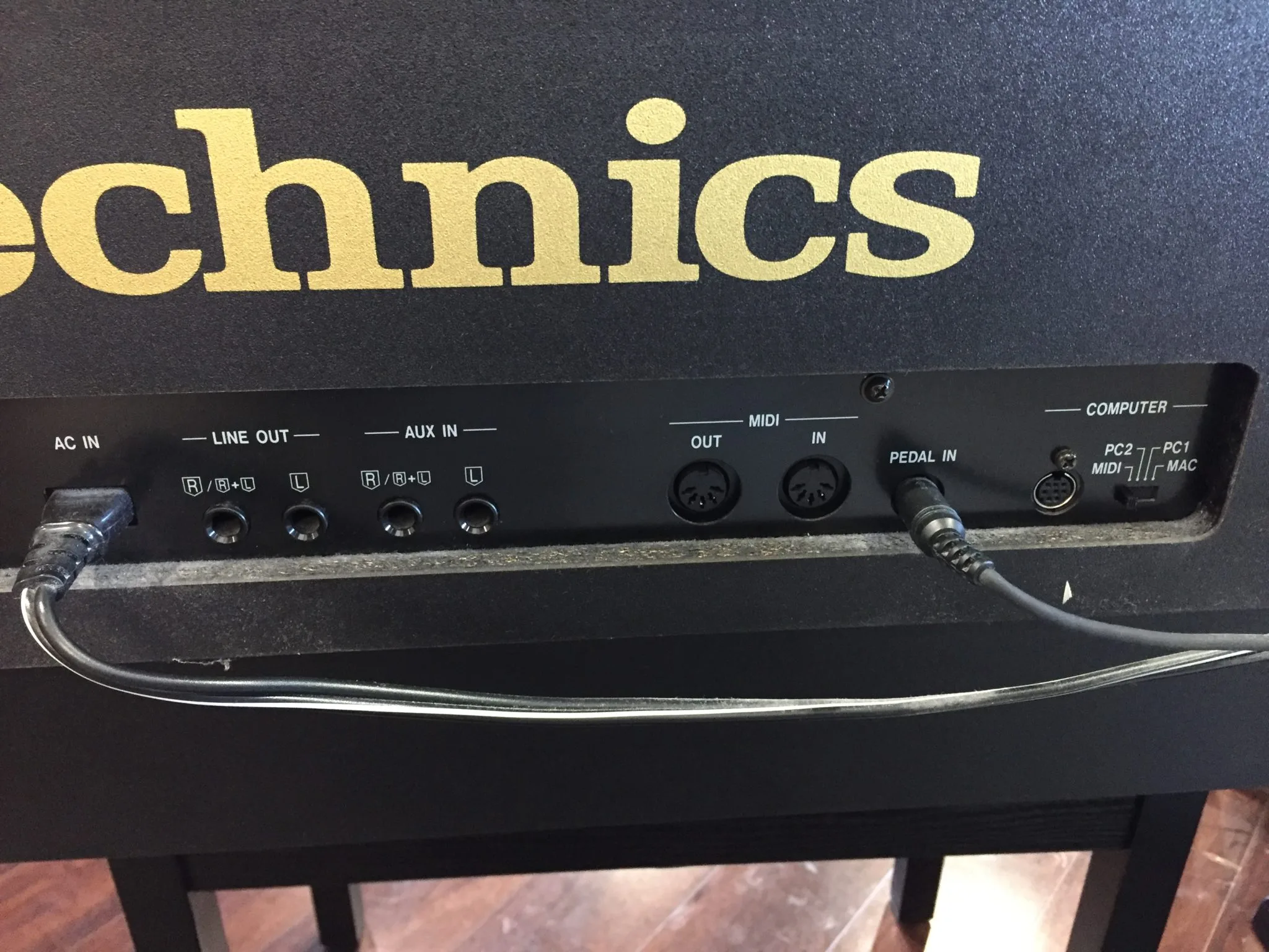

How are you connecting the Technics to the computer (PC?) According to the manual, P22 says you need an RS-232 cable type sz-jjat1 and there is a switch to get in the right position.
I doubt in fact you are using that cable so you must be going through the DIN ports of an interface. Which one and have you installed the latest drivers for it?

I have a Technic SX-PX 554, which has the same back panel as that of the Technics show in the pic above^.
I use a midi cable to go from midi out on the Technics to midi in on an interface.

By the look of the pix you provided, Reaper can see the USB midi input.
With your midi cable to USB, does it have two DIN connectors on the non-USB end? If so, try swapping them around.
Also, on the back panel of the keyboard there is a little slider switch that has a number of options, inlcuding 'midi' at its left most position. Make sure that the swithc is set to midi. This actually may have nothing to do with the actual midi output. I'm just going by my settings.

Yes, it has a MIDI IN and MIDI OUT. Here is the cable I bought:
Amazon.com: USB IN-OUT MIDI Cable Converter, LiDiVi Professional Piano Keyboard to PC/Laptop/Mac MIDI Adapter Cord for Home Music Studio - 6.5Ft: Musical Instruments
I tried switching the DIN connectors but no luck.
I also switched the slider to the left "MIDI" position, no luck.
Does the little light on the cable show a signal coming out of the keyboard?

There's a note in the Amazon description.... "▲▲▲Attention: This USB 2.0 to MIDI cable is NOT compatible with USB 3.0 devices". Any chance you're in a USB3.0 port on the computer?
A simpler option may be to just use the Tascam. Get a MIDI cable, and go from midi out on piano to midi in on Tascam.
