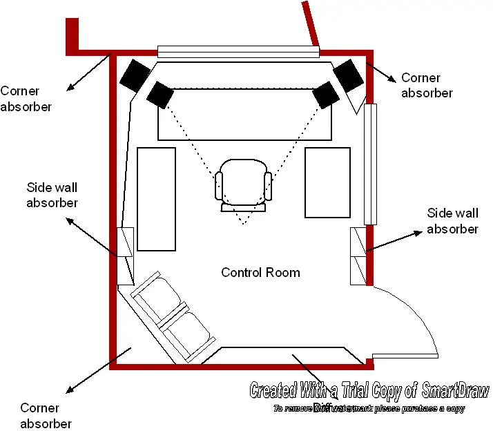

Well dear friend after going through Johns' DIY Wall Units i workedout this plan for my control room, please give your feedbacks.

Using the design that john has provided, i don't think you'd need those wall units.
those new angled walls could have the absorbers built into them.
The wall units that john developed have two main uses...
a) Stop parallel walls
b) Acoustic treatment.
With the walls at angles already (from johns design) treats the issue of parallel walls.
If you can do the acoustic treatment as part of these angled walls then there is no need for wall units. The angled walls themselves would make good helmholtz resonators (look at the sae website for details)
Corner units would make good bass-traps, or you could make low frequency hangers behind a corner panel.
Good effort though! :)

i can understand
well its' time for me to learn as i can, forunately i have something physical of my own and i can able to use it for learning things and making drawing. By drawing this i got a feedback of techie like rochey and get a good points to learn, i dont know the more better way of learning thing as compare to what i am using for the same. Thanx Rochey!
