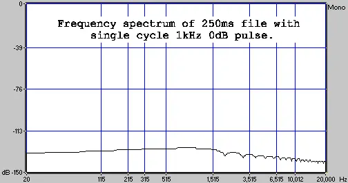

Part of the reason (not all) why a sharp transient spike sounds relatively quiet is due to it's frequency spread. The duration of a wave actually effects it's spectrum. Say you take a pure 1kHz sine wave and just play one cycle. The spectrum of this sound is actually very broad. It no longer sounds like a pure tone.
I've attached the frequency spectrum of such a pulse to illustrate this. I'll post the mp3 file next.
When sound energy is spread over a broad spectrum we don't perceive it as being as loud as when the same amount of energy is concentrated in a narrow frequency band.

Damned thing removes the attachment if you preview.
Anyhow, here's the spectrum graph.
