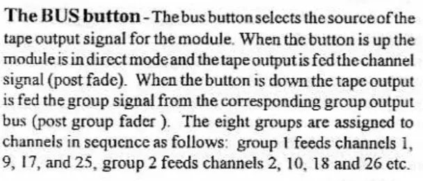

Oops...I didn't mean to have the image uploaded. I thought I deleted.
