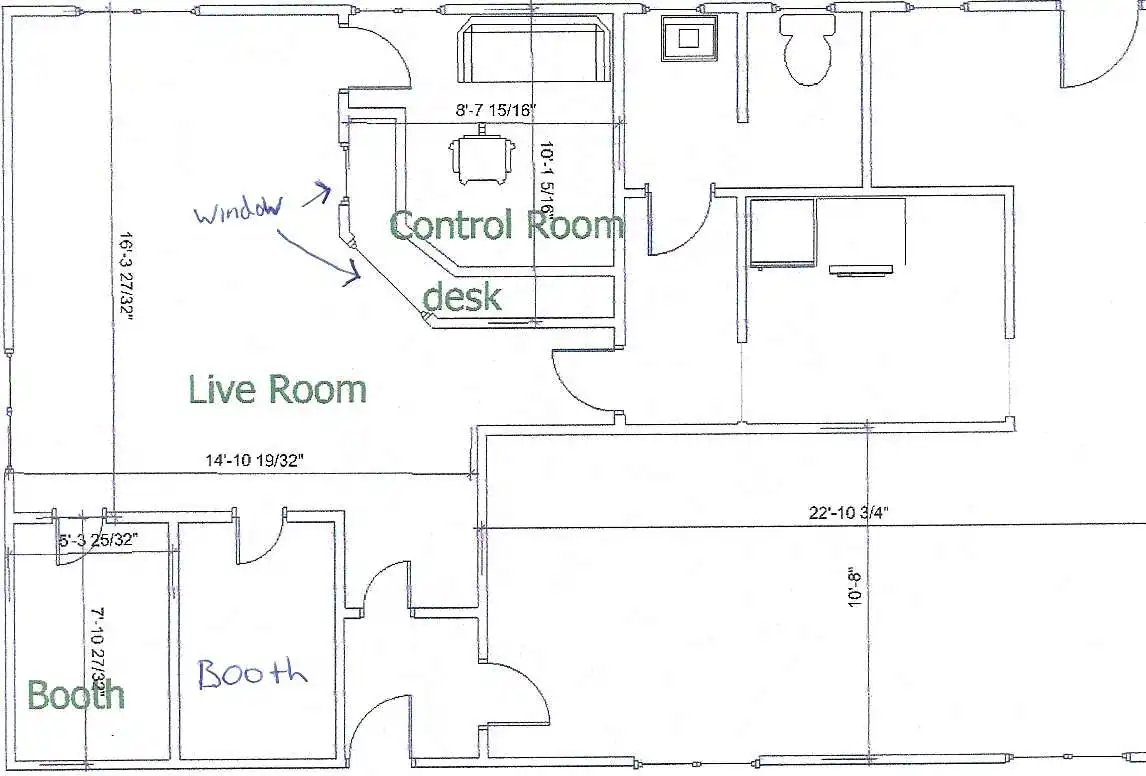

Could I please receive some feedback on my studio plan.
thanks

Lets see...
Defects:
1. Parallel walls almost everywhere.
2. Control room and the bathroom shares a common wall.
3. The two booths are rectangular (see #1).
Suggestions:
1. Control room door - since the control room is the smaller room, I'd make the door open into the live room rather than the other way around. It decreases your chance of opening the door into someone's elbow.
2. Vocal booths - is 5x8 big enough? Probably, but you might gain more use out of combining the two vocal booths into one booth, thus you can fit a large piano or a double bass drumkit. Both would barely fit into the smaller booths. Just a thought.
Good design things:
1. Airlocks - very good.
Overall its an okay design, but it doesn't illustrate sound proofing materials, so keep in mind that those items take up floorspace, thus making the rooms smaller. For example, a 5'x8' booth like you have drawn, with 3" auralex all over the place, makes it a 4'6" x 7'6" vocal booth.
How high are the ceilings in the various rooms?
i think my ignorance is going to show up here but, what's the problem with that?
whater noise?
thanks frederic

Running water.
The noise isn't a problem as usually there arent any live mics in a control room (it might be distracting though), but flooding, broken pipes, that sorta stuff might be bad for equipment :)
I know my console likes to be dry :)
Thanks for the feedback, Water problem should not be a problem because all pipes are below floor level, they come through the floor to the sink and toilet so if there was a leak the water wouldn't reach the equipment. I was planning on recording drums in the live room and recording vocals/guitar/bass in the booths and control room for 'live' recordings, at least to get the drums and bass recorded live and only dubbing vocals and guitar.
I will be mostly recording rock/metal/punk if that helps with anyone's comments.
Okaydokie, make sure when you build that wall, that you seal it at the bottom several inches "just in case". Depending on the bathroom thats there now, you can do this with a skim of cement, a plastic vapor barrier that the floor tile is glued to (that runs 12" up the wall), etc. Cheap insurance.
Okay, now get rid of the parallel walls and you should be okay. have you thought about sound treatments?
I will be mostly recording rock/metal/punk if that helps with anyone's comments. [/B]
Naaaah, music is music!
I asked a similar question a while back and the ONLY reply I got told me to go to John Sayer's site. That was some good advise. I would register for John's site and upload it to his forum.
