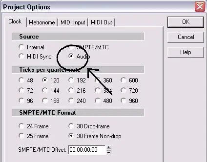

...I got you Layla...
You set the clock to Internal ? It supposed to be set to Audio. I did what you did with no problem, Sequencing the MIDI to external synth in SONAR, play it and record the synth's audio out back to SONAR as audio track... right ? Set the Options --> Projects shown here...
Hope it helps...
