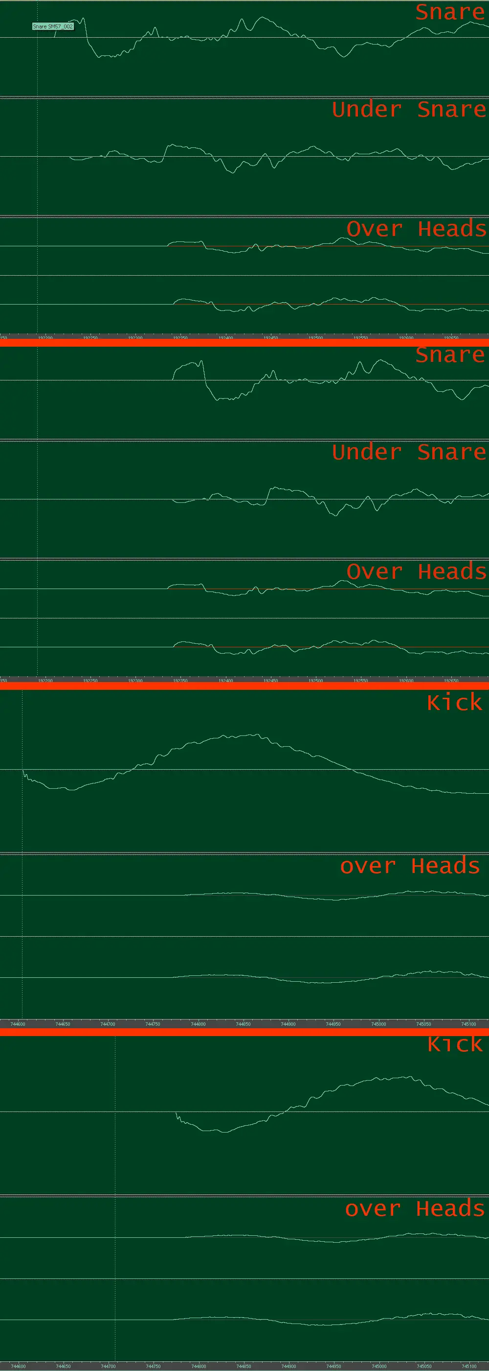

Here are some pictures of what an un-aligned vs. aligned waves look like. Phase, well that’s just a button on my DAW so it doesn’t show it graphically. But I’m sure you already know what it looks like when you invert phase.
Go ahead and load the files in your audio editing software to “see” the level difference if you can’t hear it. But I bet you’ll hear it. ;)

The picture below is split into 4 sections. I didn’t post pics of the toms, but it’s the same deal.
Section 1 Shows the stock time alignment.
Section 2 Shows the snare / bottom snare aligned to the overheads the overheads always should not be moved. Notice the under snare is inverted?
Section 3 Shows stock kick alignment. There is a lot less kick power in the overheads, that’s why it is so small. But alignment still helps. You can also see that the phase is pretty close to inverted here too.
Section 4 Shows the kick aligned to the overheads. Again, do not move the overheads, only move the kick track.
You'll also notice the overheads themselves have the snare a bit sooner on one side than the other, that can even be corrected. In this case it's a bout an 7 sample shift. Probably not even worth moving. This is best to align by better mic placement in relation to the snare.
