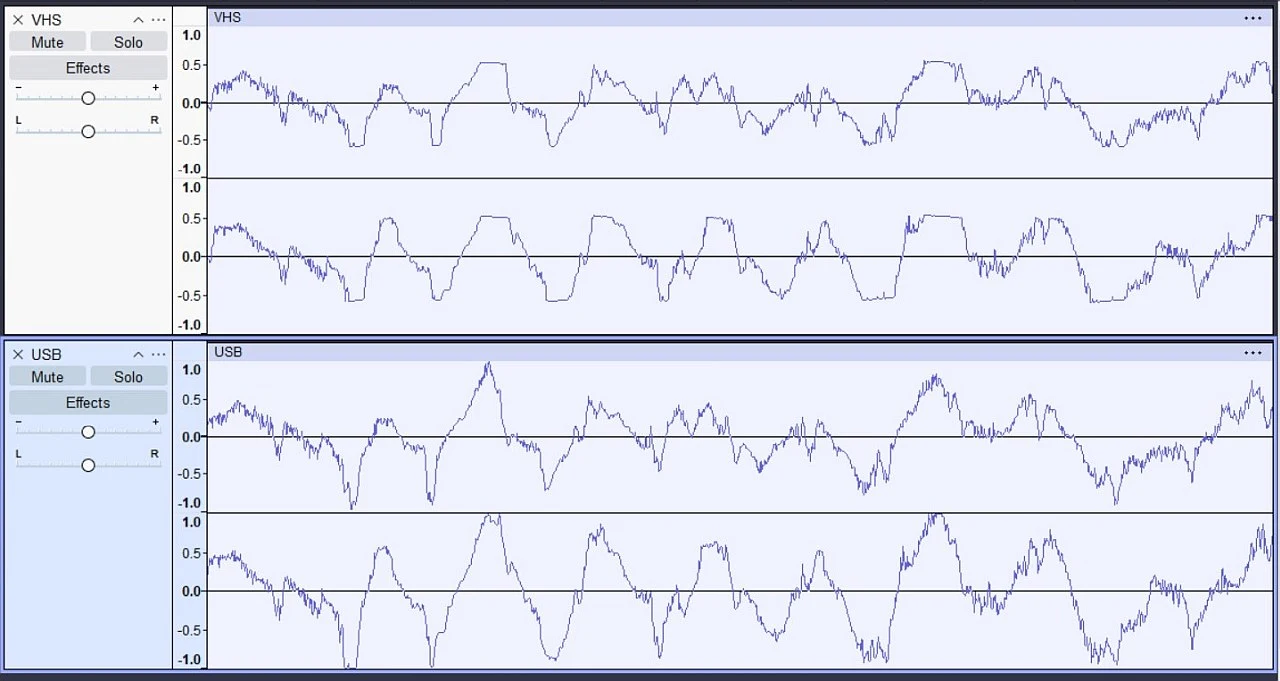

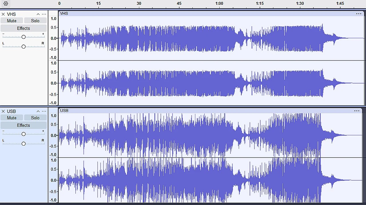

I downloaded both samples and put them in Audacity. It looks like the VHS sample is definitely got a hard limiter on it. Even the USB sample has some flat tops, which are digital clipping, but the VHS doesn't have the same max volume. You can see the effect of the AGC/Limiter.
You can clearly see the limiting in this zoom. Either it's AGC, or you overloaded the transfer to digital and clipped the signal and then adjusted down. The only way to determine would be to transfer the VHS do digital again, with a reduced input level. If you still see the flat tops, the it's the AGC.
