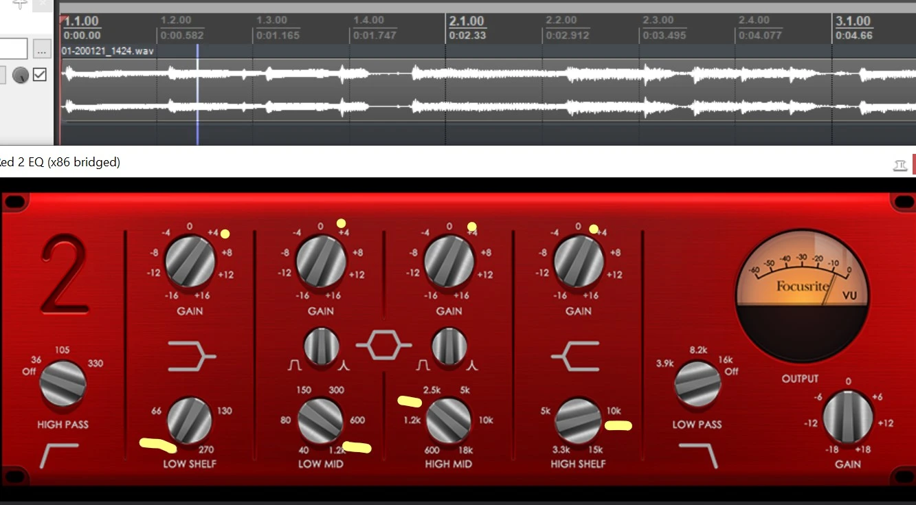

So he patches them in… he runs the track through them. He sets the low end in the stero unit to 30 at equal high boost and high gain on both knobs and shows me his fabfilter.
All of a sudden down comes that bass in the mud and this kick just THUMPS! Like I mean it SHUDDERS! (you know when a moniter breathes air on you!!
And I’m like!!!! HOLY F****** S****. HOW. What just happened.
And there it was on the fabfilter… nothing moved at 30 where he dialled in, up at 80htz where the kick was and this damn SCOOP at 200ish!!!! He drives in more bass at the start of the chain and shapes out with a fabfilter at the end, pushing it even more!!!
HE then goes to the EQ5’s and dials in a 1k and a 2k!! big wide Qs!!! On both like 2dbish each! Then he ups the mids in the 10k WIDE by between 1 and 2 db on a plugin on screen!
Then F**K out comes the VOCAL!!!! Like listening to two separate bits of music through the same monitors!!!! Im remember sitting there like. WOW its 3AM and I feel so alive right now ha
He draws the curves out for me and explains
“mate… let me tell you something and take this back to London with you… you wanna be a hip hop producer: you up the bass INTO the mud, sticky till it sound almost YUK! you Pultec 30 it, you carve the shape into your spectrum! You pump up the mid shape TWICE and high end it! He explains that if you can perfect the technique you will get every hip hop artist wanting you to mix for you because the BUMP and the VOX is ALL they care about. CHARACTER CURVE BABY!!!!!!
