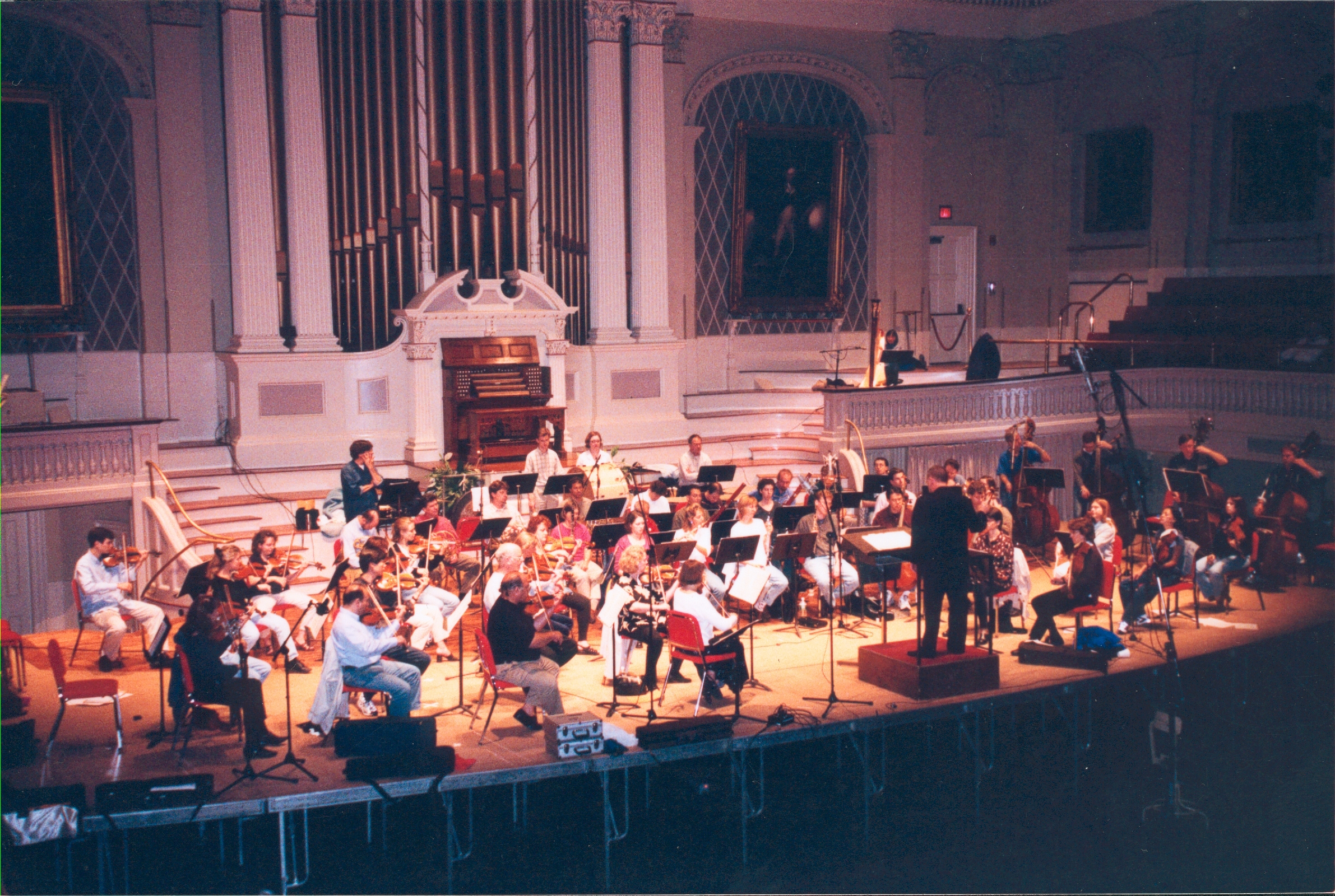

you can record an orchestra perfectly well with a pair of SM57s if that’s all you have. What people don’t understand is that orchestras are like a synth patch. Loads of separate parameters that sort of blend into the finished thing. Orchestral musicians are a music factory. Each individually talented and in demand. They also are a team. For some jobs, there will be more or less, but usually they know each other. Union membership in orchestras is much higher than with typical pop musicians. One of my job roles involved stopping the producers costing money. The engineers will suggest maybe adding outriggers to a Decca Tree. The producer lives the idea of the more spacious sound, I on the other hand, start doing the overrun sums. musicians work in 3 hour blocks, so spending 30 minutes rigging the extra mics and the length of the piece might mean they are only up to bar 96 when the magic three hours clocks up, so we’re into overtime, and overtime for an orchestra is NOT calculated by minutes, it’s hours! An extra session for ten minutes playing? It’s the music BUSINESS.
recording orchestras and to be fair, any acoustic instrument always means recording the room. Adding the room is a given, it would be great if the room added niceness, but sometimes it adds nastiness. Bad rooms means artificial reverb and closer mics. Move away from a mic and it changes.
