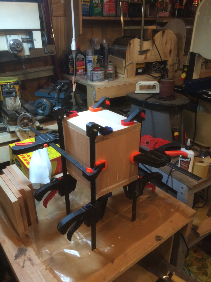

speaker2.webpFirst speaker enclosure in process... solid oak.
I have no idea why the picture is 90 degrees c-c. It's not when viewed in any other medium but this BB. Sorry folks.
Edit: fixed.

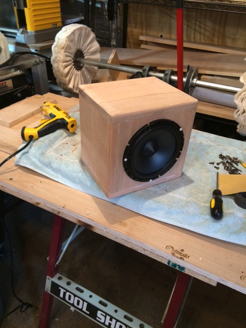

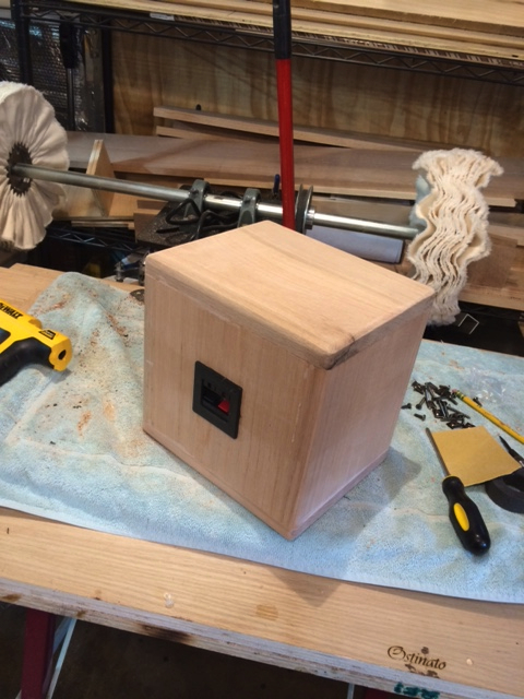

OK, the thing is done, except for finish, which can wait. I have no idea how it sounds yet, I need to go make up a cable that sums stereo to mono so I can feed it off a headphone jack. I'll post back later...
View attachment 91955View attachment 91954

Rats, wrong speaker. It's whisper faint when being driven from a headphone jack. I need to amp it or swap it out. Amping it could be counterproductive unless it's hella clean....
