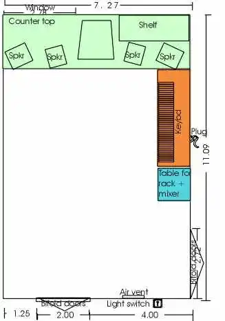

Cool.... I like in your drawing you included both of my ideas. The only one you included a drum set in was the more "square" setup. I really didn't figure that an area only about five feet wide would be enough to squeeze a drum kit into, so that makes sense to me.
What are the dimensions of your room? Have you had success putting a drum kit in and recording it? What do you do about controlling sound reflections, etc?
Chris
here's mine...
Here is roughly what I'm thinking. (see above posts...) This gives me a working/tracking area of roughly 5'10" x 8'8" if I leave the keyboard and table in place. It gives me an area of about 7'3"x8'8" if I take them down when needed. The idea of having the table where it is is that I put my mic pre, compressor, mixer, and Delta44 breakout box all there, and run moderately lengthy cables to the computer and monitoring stuff where the counter top is. With this setup, it is flexible enough to move around the room as needed, or even out through the bifold doors and into the hallway if I need to set something up in the room down the hall. (thereby requiring longer cables...)
Chris

oh btw, my dimensions are 9'2" x 11'3" with regular ole 8' ceilings. Arggggggrrrr!!!
Thanks Rick! :D That gives me a great starting point for my research!!
Chris
