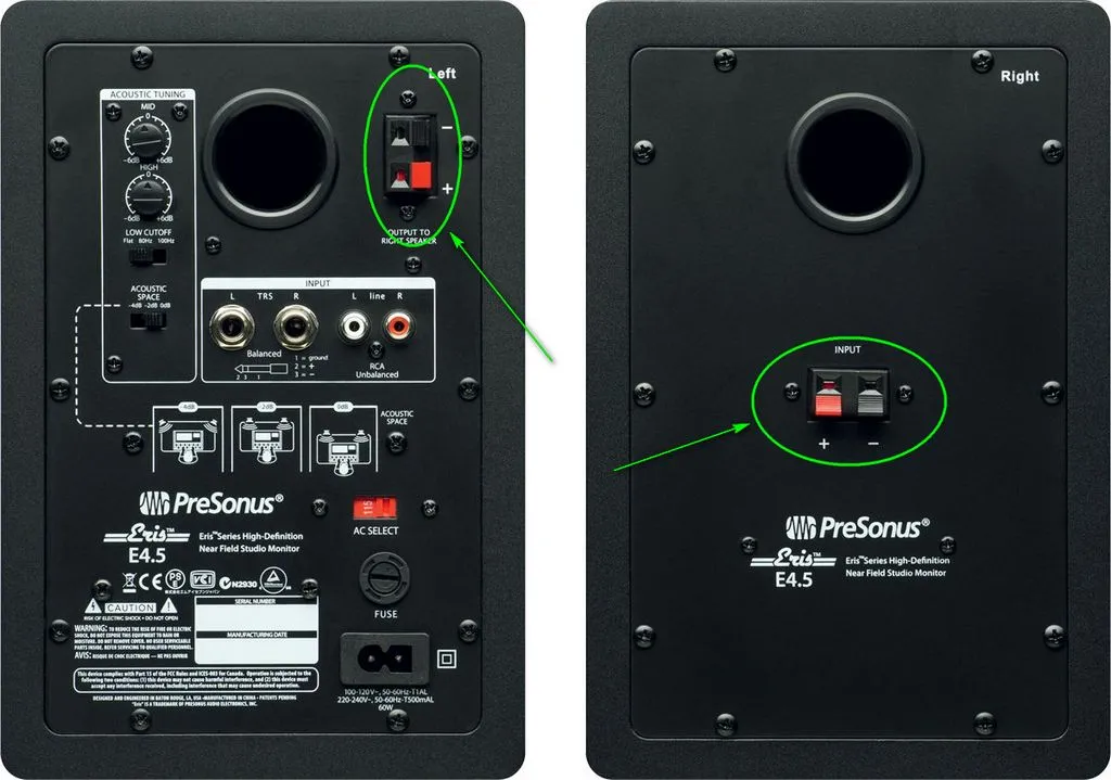

Hi, I've been a total idiot and almost for sure broken my presonus eris 4.5 speakers Eris 4.5 | PreSonus but i just want to check they can't be saved before replacing them because they are just out of warranty.
I was trying to hook up a record deck to them using an external amplifier via some speaker cable. The sound was coming through fine but i then stupidly turned on the speakers as well and the cone immediately pushed all the way out and made a humming noise on one of the speakers. Now when turn the speakers on the cone pushes out and makes a humming noise even if i have nothing connected to them and there is no other sound coming through. Are they completely broken or does anyone think this can be fixed somehow (unlikely i know).

Agree they are likely toast, or at least the powered one if the one with just the speaker connectors is just a straight up speaker.
Have you checked the "external amp" to see if that is toast as well?
I'm afraid you are correct. The opportunity presented itself exactly like that and i was too tempted think twice. I guess the other speak will be ok as its not making a horrible noise. Still i doubt i can only buy one as they come in pairs. Maybe the working speaker will have some use. I guess you don't think there is any point in looking into a repair?. I will check the external amp for any additional toasting that may have occurred right now. Thanks for the replies.

First - Don't turn them on again. If you've done damage then running them will only make that worse or permanent.
When you wired up the external amp did you run cables from Extrenal amp to speaker A and external amp to speaker B,
or did you run Amp to speaker A, then bridge across (as you would just using the speakers normally).
If it was Amp to A + Amp to B, then speaker B (the passive one) is almost certainly fine.
If not, bets are off.
Test the passive speaker with a known-to-work amplifier and set it aside.
As far as the active speaker or, rather, the one with the amp in it, it sounds like you've done damage.
However, if it's still pushing the cone out when you power on, that would suggest that the amp is damaged and the driver may not necessarily be.
That being the case, and if speaker B is fine, it may be worthwhile having someone look at this.
Weigh up what they cost and what inspection/repair would cost, but if you can narrow it down to being the internal amp which is fault, and only that amp, that'll help guide your decision.
Unfortunately I ran the External Amp to speaker A and B separately. I will test the passive speaker with a known to work amp when I get home. Thanks for the help guys.
Neither situation is good, but that's the preferable option. ^^
Speaker B is designed to take an amplifier input, which is what you fed it. Fingers crossed, that one should be fine.
Being the electronics tinkerer that I am and if I wasn't intending to have the powered speaker repaired, I might consider opening up the failed unit and try to disconnect the power amp from the speaker(s) and just running it as a passive speaker via the same connections on the rear (presuming that the speaker itself wasn't damaged). If the amp that was used isn't toast use that to drive the speakers once the failed one is modified.

Technically the buggered speaker's amplifier has gone into "offset mode" and the power supply DC is flowing through the voice coil. The amplifier is almost certainly borked and probably the woofer.
