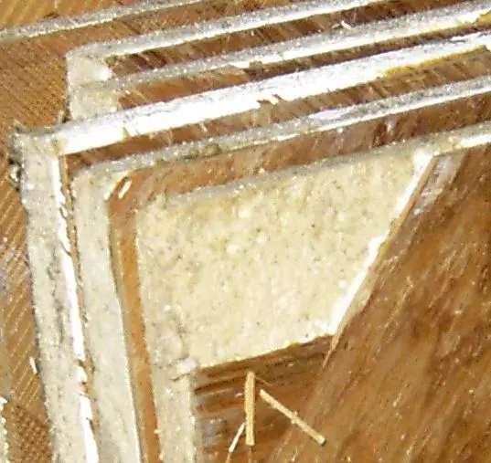

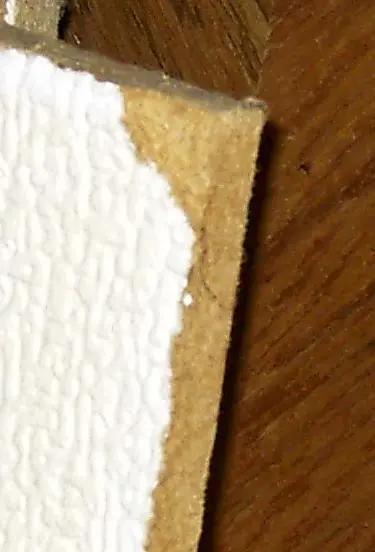

Can you post a picture?

Here's a pic of each kind I have. One has some wood planking glued onto it, but you can see a bit of the fibers in the pic, the other has a whitish covering to it which was not as easy as I thought it would be to tear off the corner.
Hmm, kind of blurry. #2 looks like fiberglass and #1 does not. I'm not sure though.
On second look at #2, maybe not. That facing would peel off fiberglass and just take a bit with it.
Hello Chill. Well, I looked at your pictures. #1 is definitely NOT rigid fiberglass.
#2 kinda looks like it, but then again its NOT what I have. And btw, I do believe these panels I have(about 25) are Owens Corning 703, although since I have never bought any I can't be sure. I found these panels in the shed out back when I bought the house. There was a box with them that had the Owens Corning lable on them and the panels are definitely yellow rigid fiberglass. They have a vinyl face on one side that peels off real easy. I am planning on purchasing some 4" in about two weeks, so I'll know for sure then.

I'd take better pics if I could, but my camera is old and has trouble with in-focus closeup shots of small areas....
The front face did not peel off very easily, it was well-attached to the material and took some of the material with it. Sounds like they may be paper. :( But at least I'll be able to break up echoes from speech at schools and offices. :cool:
