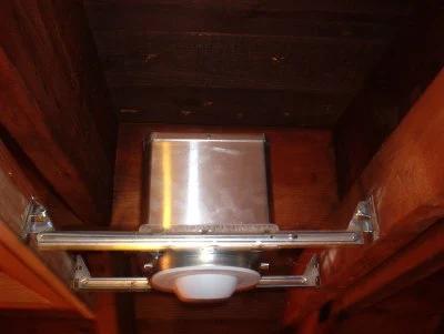

I bought two airtight cans today so I can shove in low-wattage lighting into the ceiling. According to the instructions, they are airtight and one can slap insulation on and around them.
Of course I don't see how they can be airtight with the four 3/4" holes at the top, but thats another story. To me, its like saying a spagetti strainer is useful for carrying water to a fire :eek:

I assume you are talking about IC rated cans versus non-IC cans?
Yeah... I haven't figured out how one is supposedly air tight and fire safe while the other isn't... they look the same to me :)
I think its an excuse to charge $4 more a can :)
Velvet Elvis
Yes.
Well, the ones I got are really a can in a can. I took one apart :)
Like So:

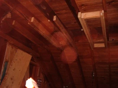

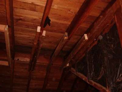

Hanging Stringers:

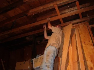

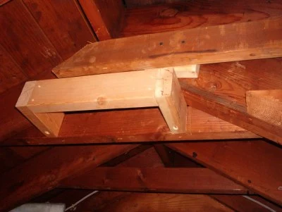

Framing overhead lights:

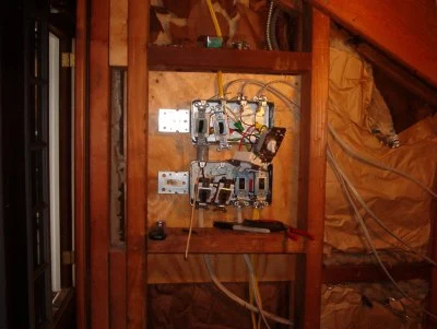

Still pretending...

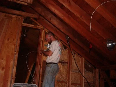

I decided to mount the switches by the door, instead of in the slanted ceiling joists. I'm going to regret this decision later I'm sure, but it was a hell of a lot easier to do. Wiring while on one knee looking up at a 30 degree angle just wasn't good. So, its now on the side wall.
Well, after I let my stomach settle for a while and posted these pictures, I got the bug to try it all out, so I spiced the secondary of the transformer to nearby junction block, turned on the overhead cans, they lit, shut it all down and unspliced off the transformer.
Woohoo!
I guess I did get the black, white, green and red wires right after all!
Heh-heh.
Finished up the electrical.
Now there is wiring for the window A/C outlet thats switched. Woohoo!
Tested it all with a continuity tester, beeps when it should, silent when it should. Definately a good thing.

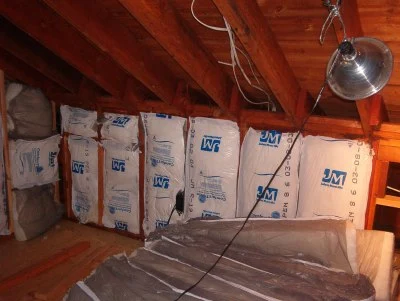

Started shoving in the insulation. Its fiberglass battings encased in plastic, thus designed to be thermal, acoustical insulation (though I'm sure the latter is not terribly effective) Staple the plastic all around, and it acts as a vapor barrier. So the documentation says. I'll decide after I have it all up if I need more plastic barrier or not.
It goes up quick, and itch free. Cutting the batts to fit is easy with a new blade, that one could shave with. Slices right through, no dust, no muss, no mess.
And yes, I wore goggles and a filter mask. Definately not taking chances.
Insulation pictures!

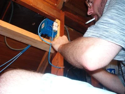

Installing 2 cat 5 jacks, in a duplex housing.
Top jack will be a 1gb feed to the basement.
Bottom jack will be the webcam in the back of the room.
Screwed to the wall just below this outlet will be a Netgear GS108 10/100/1000 mb ethernet switch. Product info:
http://www.netgear.com/products/prod_details.asp?prodID=152&view=
Essentially this will be the network for the studio, allowing the webcam behind me, the studio PC, the "everything else PC" etc to be connected to the remainder of the house's infrastructure. I did a little research and the 1gb ports on this switch will be compatible with my HP Procurve 1gb ports in the basement along with the rest of the network junk (www.midimonkey.com).
Anyway, I'll have extra ports in the studio in case I want to put in a network printer, or plug my laptop in, stuff like that.

Nice pics man... I especially like the one with the cig hanging out of your mouth... bwahahahahahaha... you wear a mask and goggles cutting insulation, and then stick a tar/tabacco stick in your mouth right afterwards :)
Do they allow you to run network and electrical to the same box there? Here in Iowa thats a big no no.
I have to use seperate wall boxes for network/phone from electrical.
Technically, its an illegal box here in NJ as well. However, the only thing I have to have inspected is the connection to the breaker box. What I do within the house is acceptable, according to local regulations. So, I have the inspector look at the breaker box, and thats it. He and I are chums at this point, he was here a week ago looking at the breakerbox because I'm about to have it upgraded to 220V, 200A. So he was taking before pictures.
He did identify there was a lot of "add on" wiring that he's not sure where it goes, and I simply shrugged my shoulders saying "it was there". Its grounded properly and tied in correctly on appropriately sized breakers, so its fine.
The blue cable that I ran was cat 5E (gigabit ethernet), and is not the regular cable you'd find at a local store. Its shielded, AND smoke free, darn good stuff. So I have the shielding tied to the patch panel in the basement (Krone) which in turn ties to the aluminum racks, which in turn connect to a 3' copper grounding wire which in turn attaches to a 6' long spike I hammered into the foundation. Well, 5'8" of the spike is underground. I have four inches above for ground terminations.
