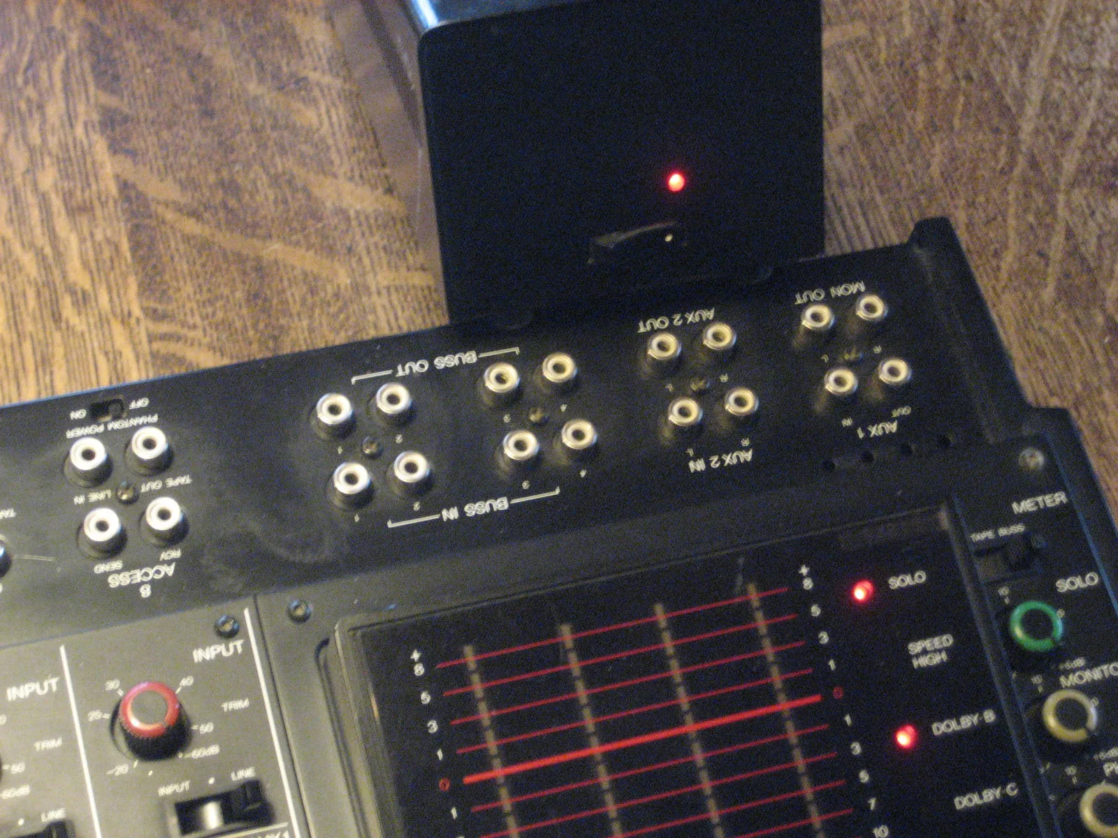

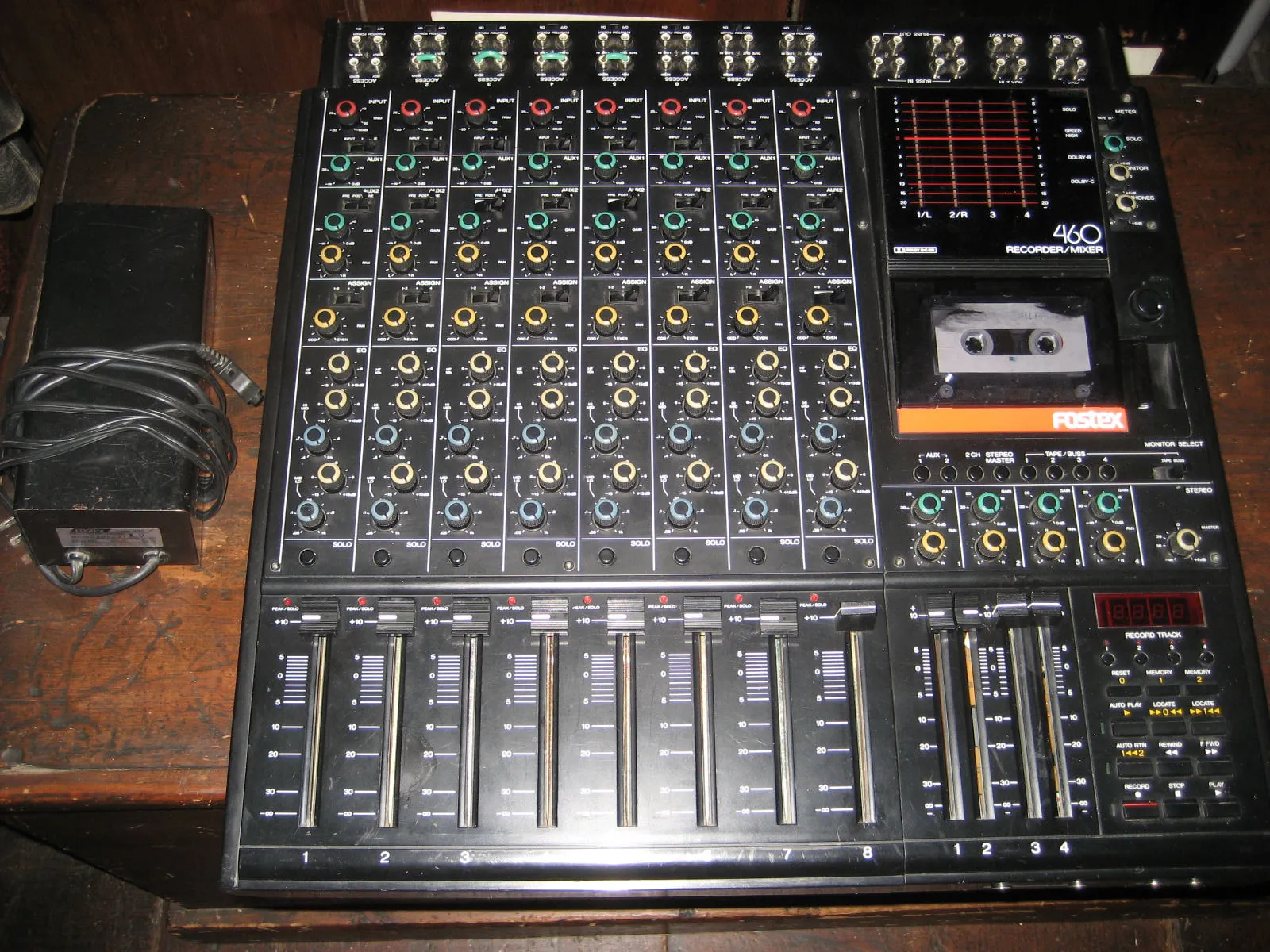

Cool! Is that giant brick beside it the power supply???? Is it yours.?
Nice!
Sure love to have a pic of that without the flash and without the bottom right corner cut off! :p
Is there phantom power on that sucker too?
Cheers! :)
Not mine.
The brick is the power module.
It runs Dolby B and C, High & Low speeds. A pretty capable mixer with Aux Snd/Rcv patch points, (2) Aux Send submixes (1 mono & 1 stereo), and Solo.
Neat.

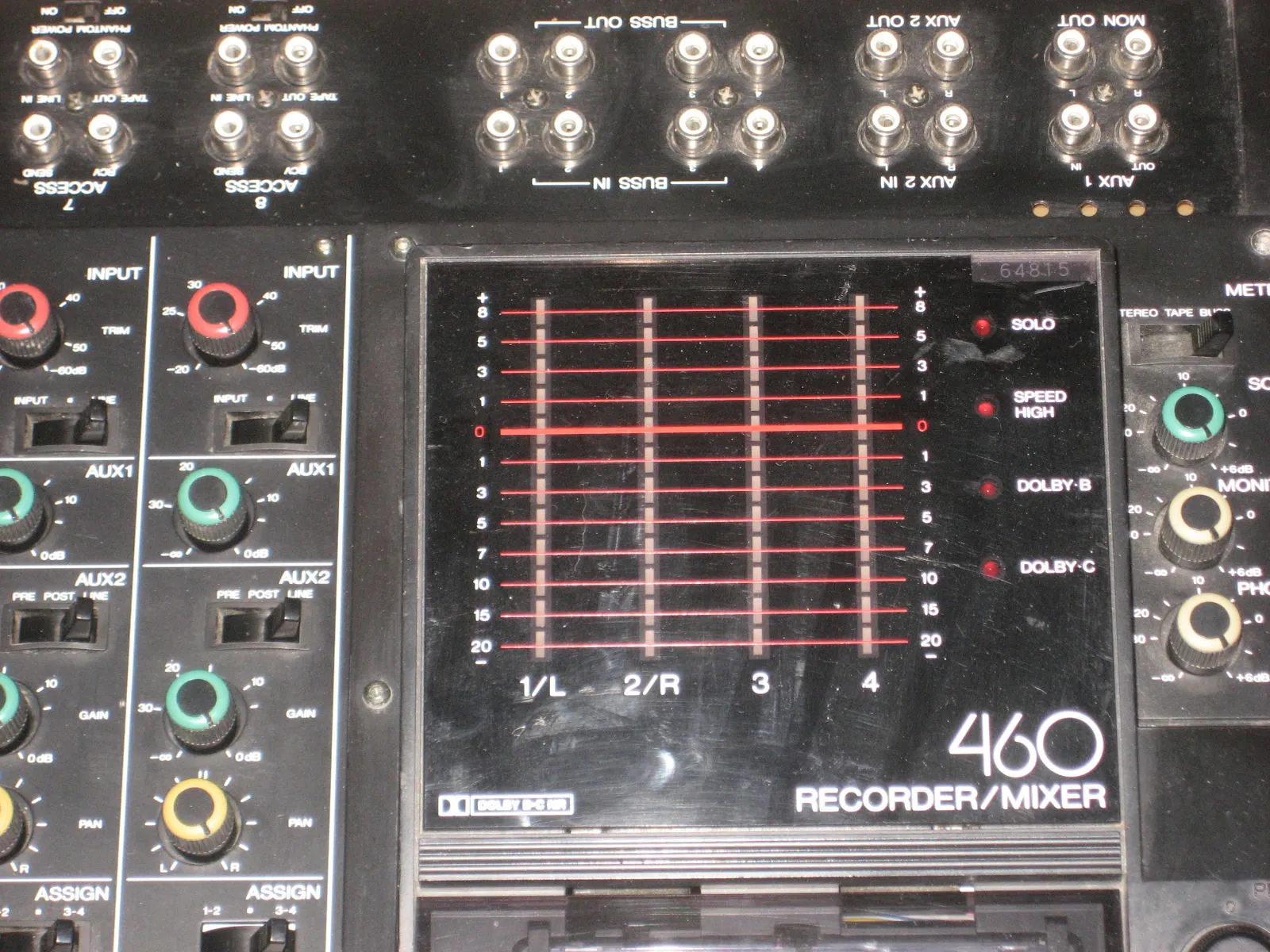

Phantom...
WAIT! About 10th in a series of pictures, I see that it DOES have phantom power! (I guess I missed it in the 3rd photo).

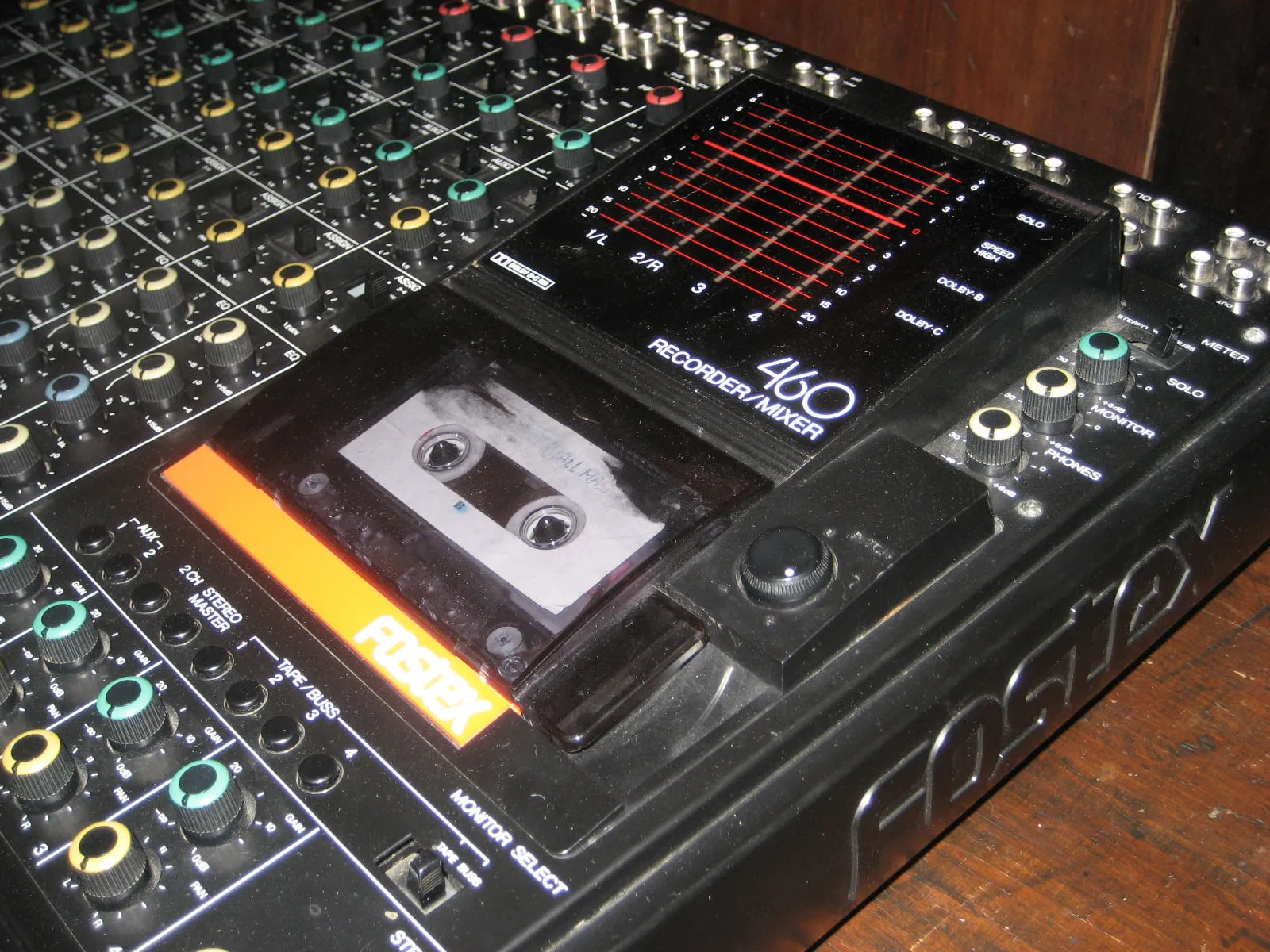

Very Cool. I've seen these for sale online before, but not too often. Very nice that it has Phantom Power, I'd always thought the Tascam 488mkII was the only cassette based Multitrack with it. The Eq Section looks great too. I assume this is a 4 track unit?
There were 2 up on eBay this week.
This one's still available:
Fostex 460 Recorder Mixer | eBay
It's a cassette 4-tracker. Maybe the best/most capable Fostex cassette multitracker ever made. YMMV.
