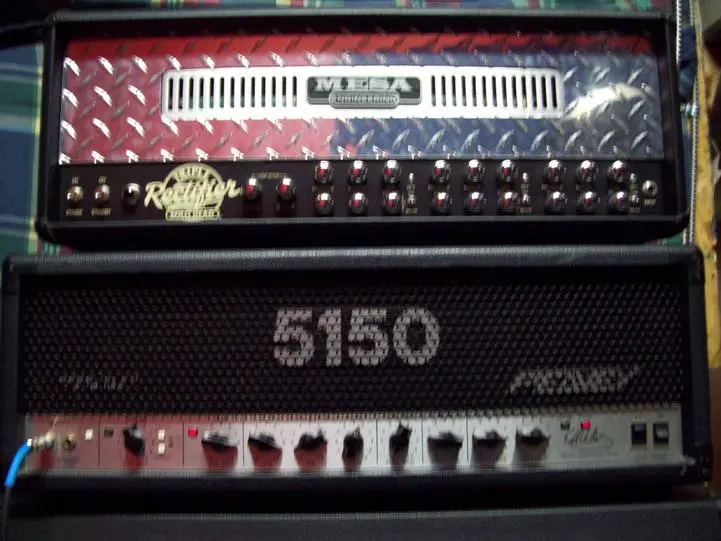

It's only when cranked on 6 or 7, it does start to lose the thick gain sound we like to have almost 100% of the time. (what most people use for a "solo" type gain sound, only to boost on a solo part,..we use that sound all the time...our sound is saturated with gain)
I don't have any recordings at those levels, cuz we don't turn it up that loud, when recording. The only time we turn it up that loud, is when we play a place that doesn't have an in-house P.A. system with subs, etc. makin it possible to mic the cabs. So,..we end up startin' to lose that thick sound when the guitar gets turned up. With all the amps,..with the exception of the Boogie (that one does alright, on 6-7).
This is the reason, why I'm asking about the hot plate.
Would some type of mod be in order for the amps,..instead?
When we do record,..It is usually one of the top speakers (sm57) on the Mesa...and one of the bottoms on the 5150 cab (sm57). 4-12 cabs.
The JSX has an excellent line-out from the cab and head, that we record it's tracks with. We definitely are getting the sound we are lookin' for at the practice spot, 'cause we only need to keep the volume around 3 or so, on all the amps,..except for the JSX,..that one only needs to be on 2 - 2 1/2.
It's when we need to turn the volume up,..which is not very often,..but I'd like for our sound to retain itself everytime we play.
From everyone's comments so far,..it doesn't seem like it's (hot plate) gonna do much. Not worth puttin' $250.00 out anyway.
