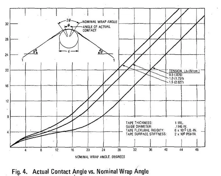

The wrap angle is the number of degrees in which a tape in contact with a cylinder (well this is not actually true as the wrap angle and contact angle are different in a complex way based on the physical distortion of the tape in the contact area)
Heads are not typically cylinders and this complicated the matter but we can disregard that.
Push the cylinder further into the tape and the contact area goes up.
If we define a center-line to the cylinder then we can have that center-line bisect the wrap angle (i.e. the cylinder is tangent) or the center-line can be offset in the wrap angle (i.e. the cylinder is not tangent).
The terms come from the math and may be used (improperly) by various vendors.
Here is a photo I snagged from an ieee paper on wrap.
--Ethan
