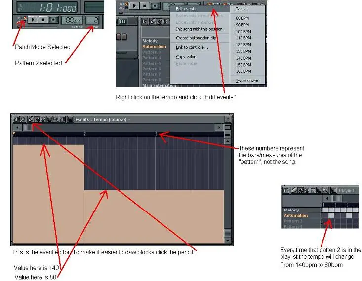

Use the event editor.
in a separate (empty) pattern (make sure 'pat' is selected next to the play button)
right click on where you change the tempo and click 'edit events'
Use your mouse to draw how the tempo will change. While hovering your mouse in the event editor window if you look under the tools and help menus the nemerical value of the tempo is displayed there.
Whenever this pattern is in the playlist the tempo changes in the event editor will occur.
You can also use this technique to change volume, cut, res, effect parameters or just about anything.

I've attached a zipped loop package where I've just cot a 3xOSC playing the c major scale alternating between 100 and 140 bpm.
In pattern 2 right click on the tempo and click event editor to see how it's done. Just make sure that when you enter the events next to the play button the "pat" is selected because sometimes events can apply to the whole song, not pattern you've selected.
I allways put the events in a separate pattern than instruments just in case I don't want the event to occur in parts of the song.
When you download the file you do not have to extract the zip, just open the zip with FLstudio
enjoy.

The numbers are for measures i.e. 1 square in the playlist editor.
Anywhere i put the automation patter in the playlist, that tempo changes will occur.
Note The automation is 2 bars in duration and is played twice in the event editor, I st a 2 bar automation and repeated it.

And if you open the zip that's exactly what I've done. The tempo changes, then it changes back using an the automation in pattern 2.

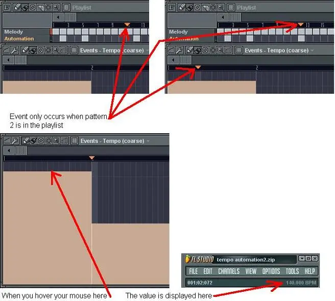

Just to make it even simpler I've done another example with a diagram. If you don't get that then FLstudio is probably too advanced for you.

There we go, a silly 2 second job that goes at 140bpm for 4 bars. Then when the "140 to 180" automation pattern is played in the playlist editor, tempo will change to 180 for 4 bars
