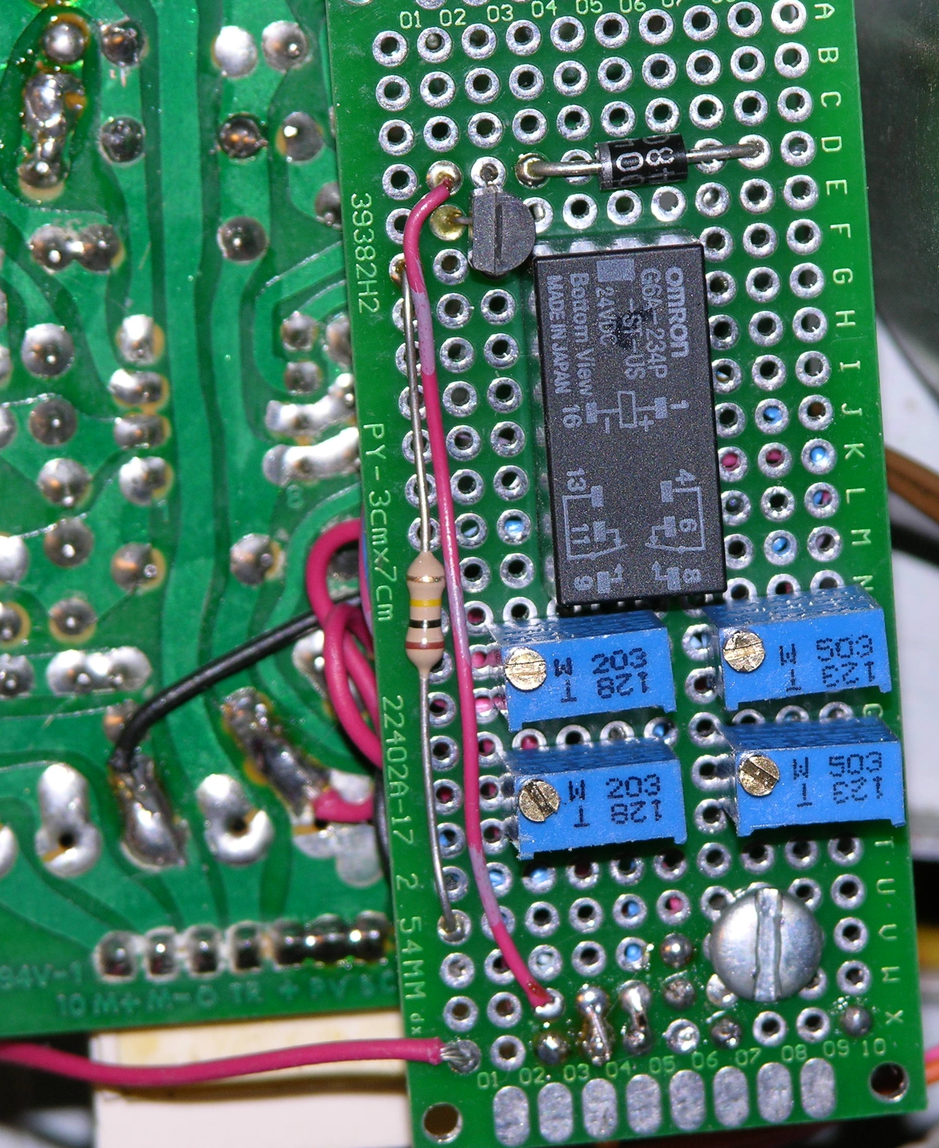

I have also often seen the need to have an adjustment for the different directions on the X1000R or X10R. Well I said one day a guy will figure this out and offer a upgrade kit. The problem is why does it always have to be me.
Well I took a signal off the direction control and isolated through a 100K resistor then into a transistor that switches a 24V DPDT relay. Now when the deck is in either direction and either speed there is a 10 turn trimmer to get the speed exactly where they need to be. These are hooked into where the original pots were at for speed control but now it is possible to put a speed tape on and get each direction and speed within 2Hz of each other. Again this is the way the deck should have been designed. I have not done one for the X2000R yet but the change there can not be that difficult. The X series decks like X3R , X300R, X-7R, X700R all use about the same servo PCB so it would be applicable to all of these.
