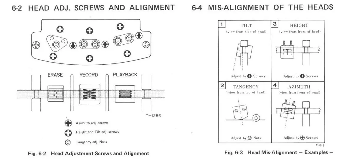

Thanks for the diagram - I have only turned screws back and forwards so far
Could you decipher what the definitions are at the bottom for each type of screw as the jpeg is unclear
thanks again
Sorry about that. Automatic resizing at work.... Lt's see what this one looks like.
Have you aligned a deck before? Getting your heads Az adjustment the same as those which printed the signal on the tape would be a first step. Then setting the reference level and EQ to match.
Thjats the one thanks very much ethan - I think I guessed right but its reassuring to see. tapes I have been given have no tone at all so I am just having to do the best I can before twisting back after ive done the tapes. I know not to just randomnly twist

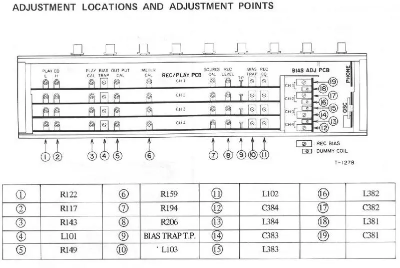

Hi Mick,
You will need an MRL tape to do a proper calibration and those manuals that you ordered. You are in the UK? Welcome to the list by the way.
I'm assuming that you have not calibrated a deck in some time and are a bit rusty on doing it. The azimuth adjustment is a very fine adjustment and tweaking it the trying to get it back just does not work very well. But given the age of the deck we can assume that the record head was not in alignment to start with. And that you did not adjust the record/sync head.
The thing to do would be to get the MRL and Manuals then go through the full alignment procedure. If needed we can help with any questions you might have.
This puts your deck to its best and allows you to exchange tapes with other decks (that are alighned properly) with little fuss.
Once the deck is aligned to standards you can adjust the playback head azimuth to match what was printed on the (old) tape. This works better if they printed a test tone set on the tape. When az matches you get the best results.
When you are done with that tape you can put a scratch tape on the deck and record a tone and then adjust the playback head to be parallel. Thus alighing it again to industry standards. I'm assuming that you are not adjusting levels, just azimuth.
As you know doing a calibration is not too hard but it needs to be done in proper sequence and properly for best and repeatble results.
Here is the location of the internal adjustments. Your manual is your friend.
Regards, Ethan
PS You will need a hardware or software oscilloscope to do the Azimuth adjustment
