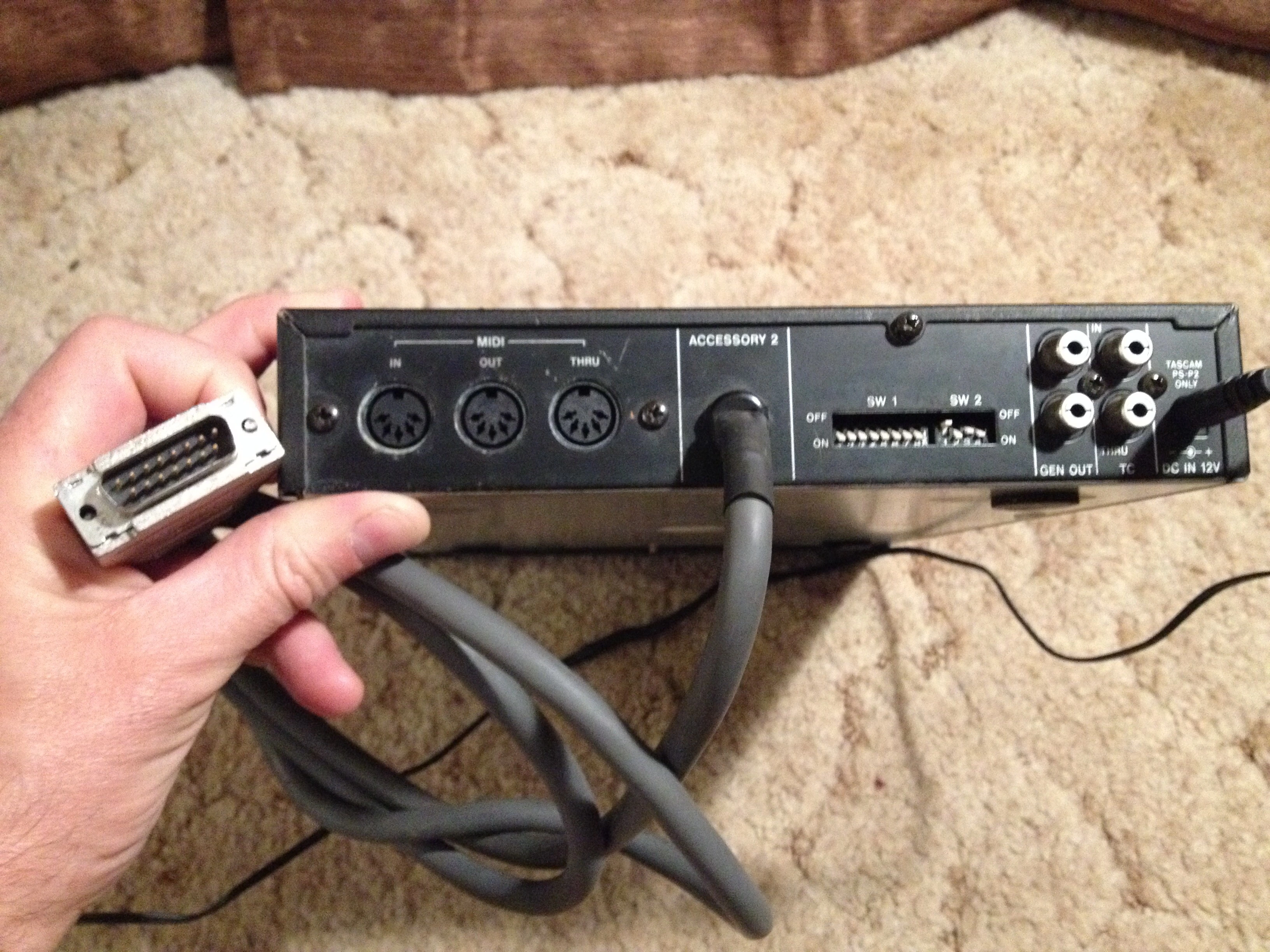

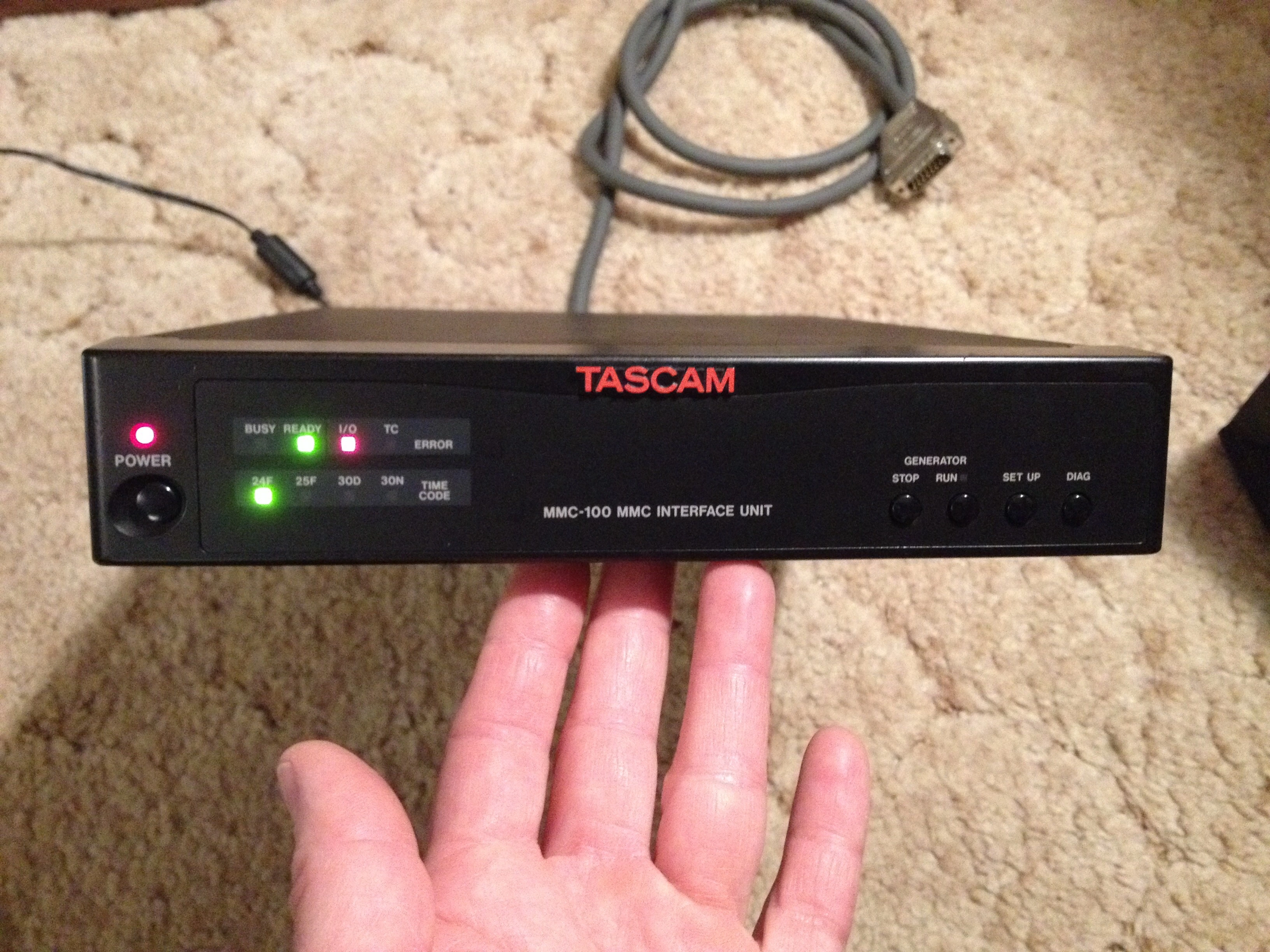

Anybody know anything about the Tascam MMC-100? I have one. I don't think I want/need it, but without spending time reading the pdf manual I found I'm just trying to get my noggin around what it is/does. I'm thinking it is a basic sync box to enable a MIDI device to chase the tape deck, like with a JL Cooper PPS-2. Anybody know if I'm on the right track? Beck? Ghost? Came with a 238 I bought awhile back, and it has a captive 15-pin DSUB "ACCESSORY 2" cable for interfacing with the tape deck.
My understand of this unit is that it's designed to slave midi sequencers to various ATRs from tascam which have the accesory2 15 pin connector, writing and reading back time code off the tape to force position and tempo info to the midi devices.

AFAIK they don't have the ability to lock the tape deck to an incoming timecode, at which point I lost interest and haven't used mine either...

What you can do is lock together two TASCAM machines via the ACCESSORY 2 port. What you do is record timecode to your chosen track on both machines at the same time. Then one machine acts as a master while the one connected to the .....scrub all that, I'm thinking of the ATS 100 or something.
By the looks of your gadget, it probably allows the ACCESSORY 2 enabled machine to timelock to Midi timecode, rather than the midi chasing the tape machine.

The MMC-100 doesn't provide for tape deck synchronization to a sequencer nor from one tape deck to another.
MMC (MIDI Machine Control) allows a software or hardware controller to control basic transport functions of another device like Play, Stop, Pause, Record, as well as Locate. In this case the MMC-100 was designed for certain Tascam products that have the Accessory 2 port... 238, TSR-8, MSR-16, etc.
The MMC-100 does however convert SMPTE to MTC (MIDI Time Code) which allows a sequencer to slave to a tape deck when SMPTE is striped to one track of the ATR and read by the MMC-100. You could use it that way without using the MIDI Machine Control functionality of the Accessory 2 port. You can also use the remote control function via the Accessory 2 port without using the sync feature.
So basically the MMC-100 can be seen like any SMPTE-to-MTC box (JL Cooper, Philip Rees etc), but with the addition of MMC to allow remote control of ATR transport functions. The device generating the MMC commands could be a computer or a MIDI keyboard controller.
If using both features together you can start the ATR from a computer and then the sync track on the ATR sends SMPTE to the MMC-100, which converts it to MTC and sends it to a sequencer, which slaves to the Tascam ATR.
