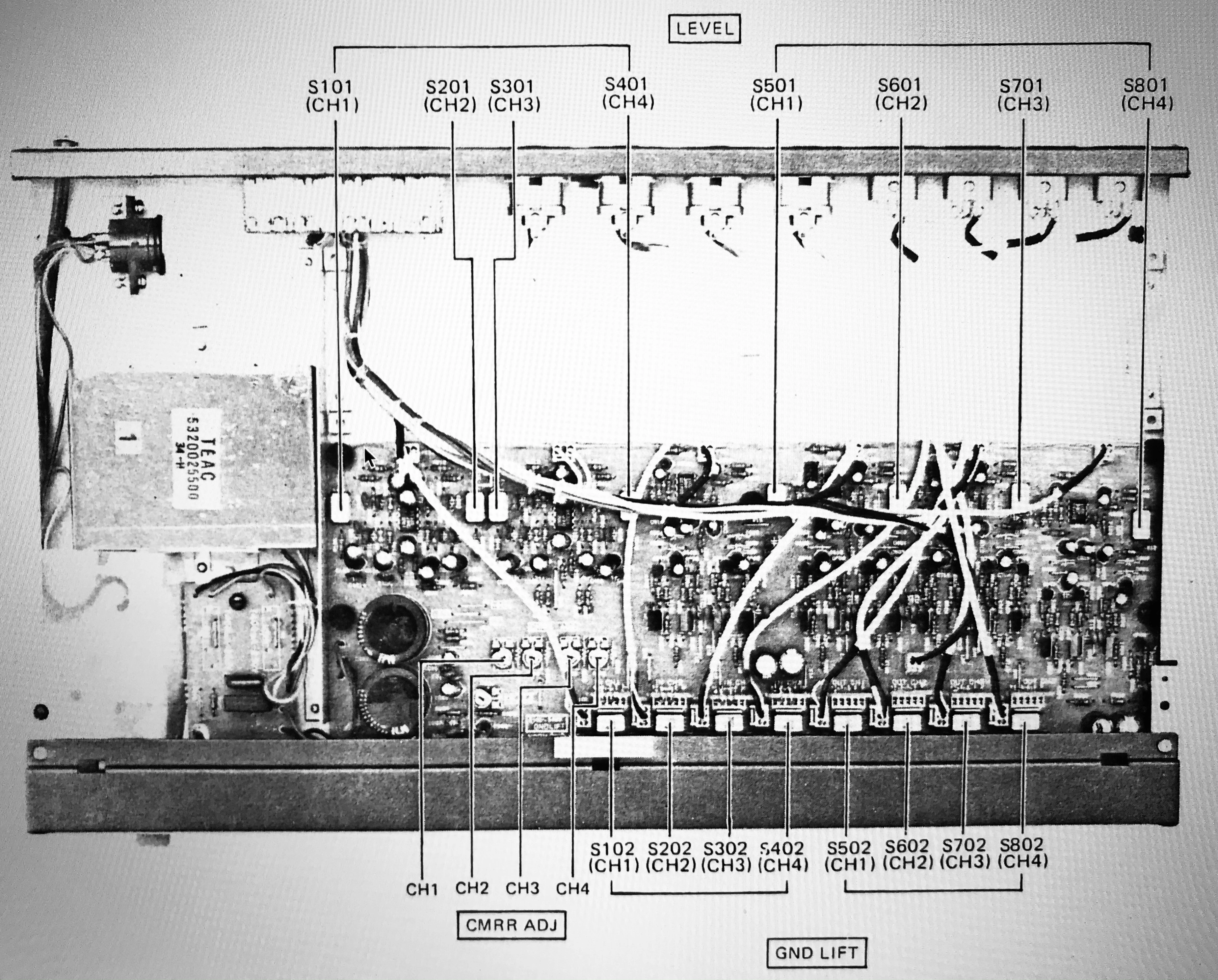

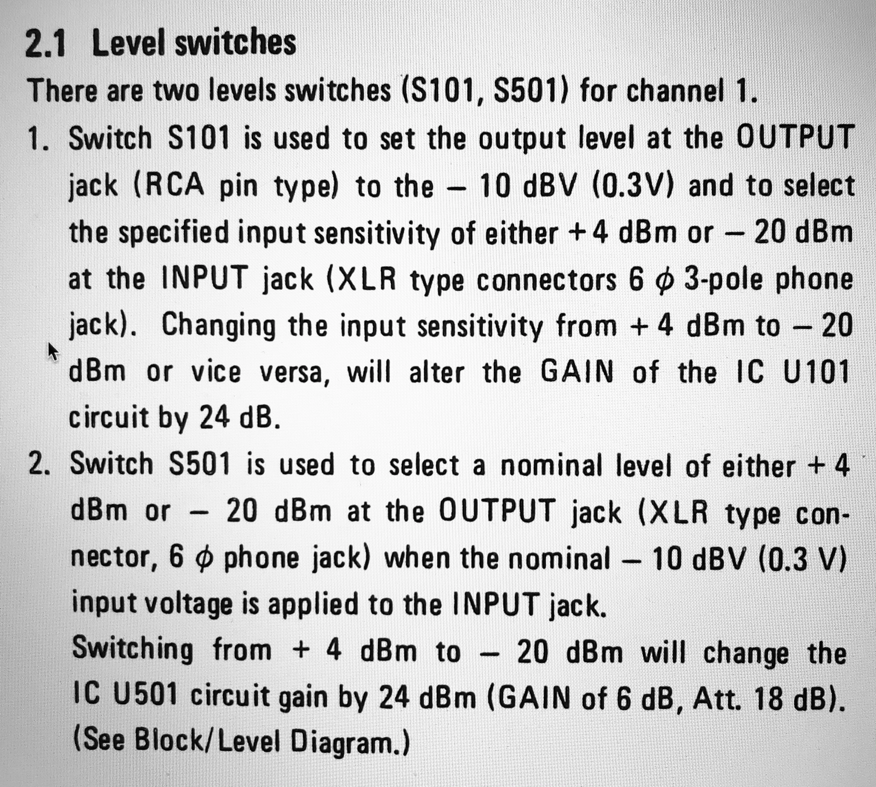

[MENTION=204989]yoshi420[/MENTION] I was finally able to locate my LA-40 Service Manual and found some info in it that may be helpful...maybe more than what is in the Owner’s Manual...or maybe not...they may have included this info in the Owner’s Manual. But the short of it is the switches are on the main PCB inside, accessible after you remove the chassis cover. I’m attaching a couple pics to this post.

The first thing I would do is remove the top cover and exercise all the level adjust switches the span from left to right across the rear portion of the PCB. And also verify your connections are appropriate. If the problem is global across all 4 channels, it could be user error, or, if not, a problem with the power supply. So:
1. Verify you have things hooked up correctly and maybe even share the setup here (and note the the XLR jacks are pin 3 hot/high, which, depending on your individual setup, can be problematic for signal continuity)
2. Exercise the level adjust switches, and
3. Check the +/-15V supply outputs…like just measure for DC volts from pin 4 to ground and pin 8 to ground of any of the 5532 or 2041 audio opamps.

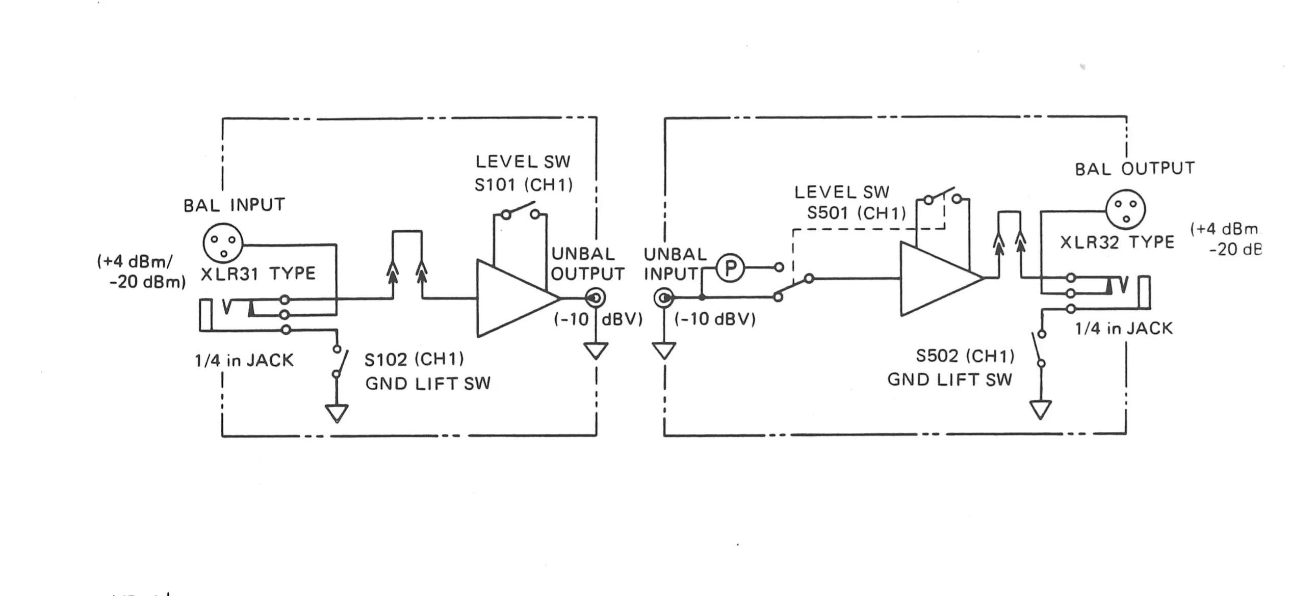

The LA-40 is not really a patchbay. It’s a leveling amplifier (hence “LA”). It converts balanced +4dBu type signals to unbalanced -10dBv type signals and vice versa. Balanced +4dBu nominal signals connected to the 1/4” or XLR input jacks are unbalanced and level-dropped and output to the correspondingly numbered RCA jacks. Inserting a 1/4” plug into a 1/4” input jack breaks signal from the correspondingly numbered XLR input jack. And conversely unbalanced -10dBv nominal signals connected to the RCA input jacks are balanced and level bumped and output to the correspondingly numbered 1/4” or XLR jacks. Inserting a 1/4” plug into a 1/4” output jack breaks signal to the correspondingly numbered XLR output jack. Here is what I just described in a picture…the Block Diagram:
