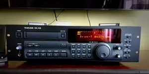

Hello All
My first post here as I need some advice from the Forum. I have just been offered a brand new, never opened Tascam DA-40 (and a CD-450) for $120USD a piece.
My question is, considering the TASCAM DA-40 is from 1999, would it still work properly out of the box, I mean the thing has been sat in storage for 19 years!
I can trust the CD Player working but I'm not so sure of the DAT with all its moving parts and rubber belts? Has anyone had this experience before.
I only want to buy the unit as I want to archive my olde music I recorded some 26 years ago, haha.

Thanks Mickster, I took some tapes and alas, the machine booted up, took the tape and kept it with the error on screen 'Mecha Com Err'. So that was a shame, the seller said I could take it for $40USD as a result. Before I did though he said he had 4 more, he will check out which of the remaining ones works, if not I can take any for $40! RFR, thanks for that advice, based upon what you wrote, I will take one either way then and give it a go! Preferably take a machine without a stuck DAT tape, just in case :) I did take the CD player home, that works fine!

Get someone to service what you have. The NOS one will almost certainly have the same problem: all grease has hardened because it wasn't used for a very long time.
Well, I finally got some new belts and had it professionally serviced. It was given a clean bill of health and it works like a charm. I have thoroughly enjoyed listening to this machine through my Hi-Fi, elegant. It certainly was more exciting than a HDD :)
