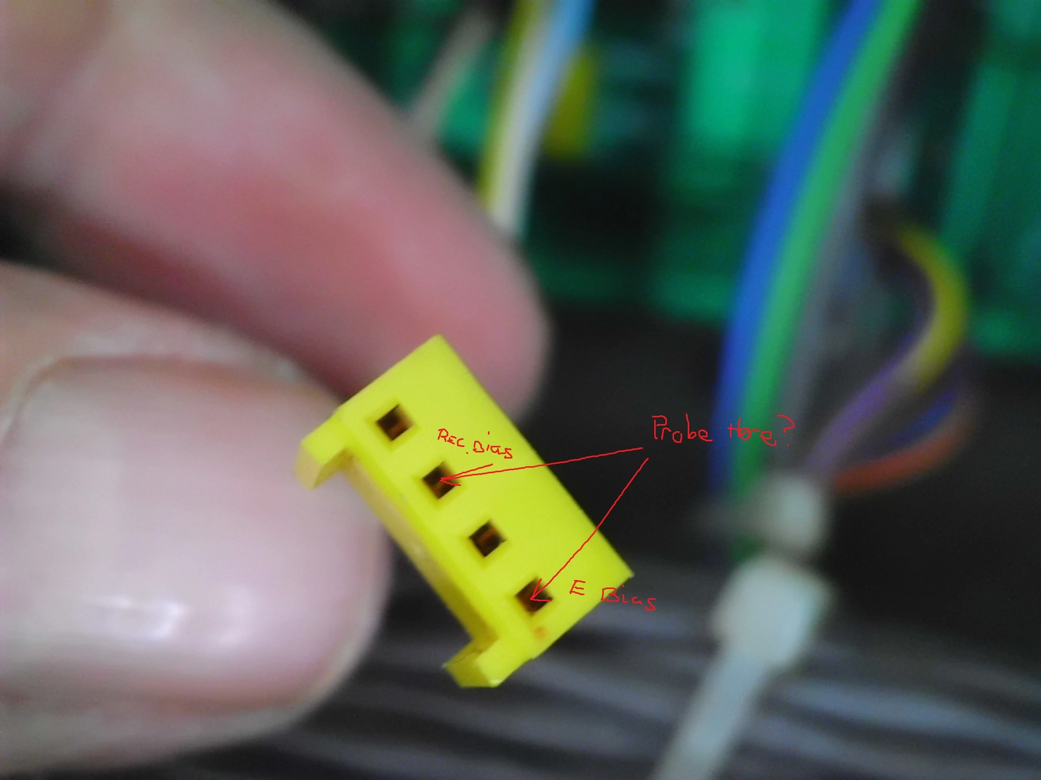

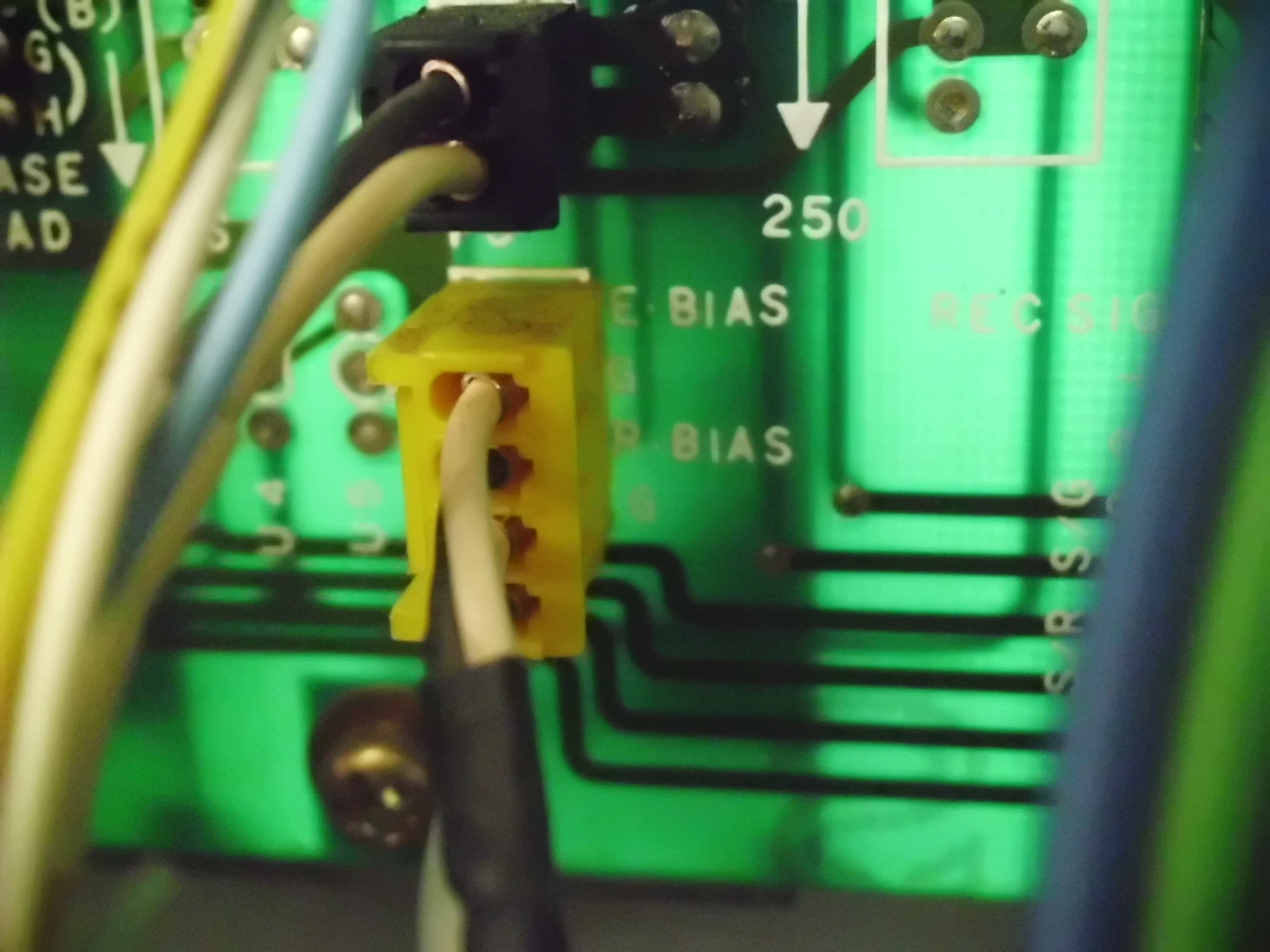

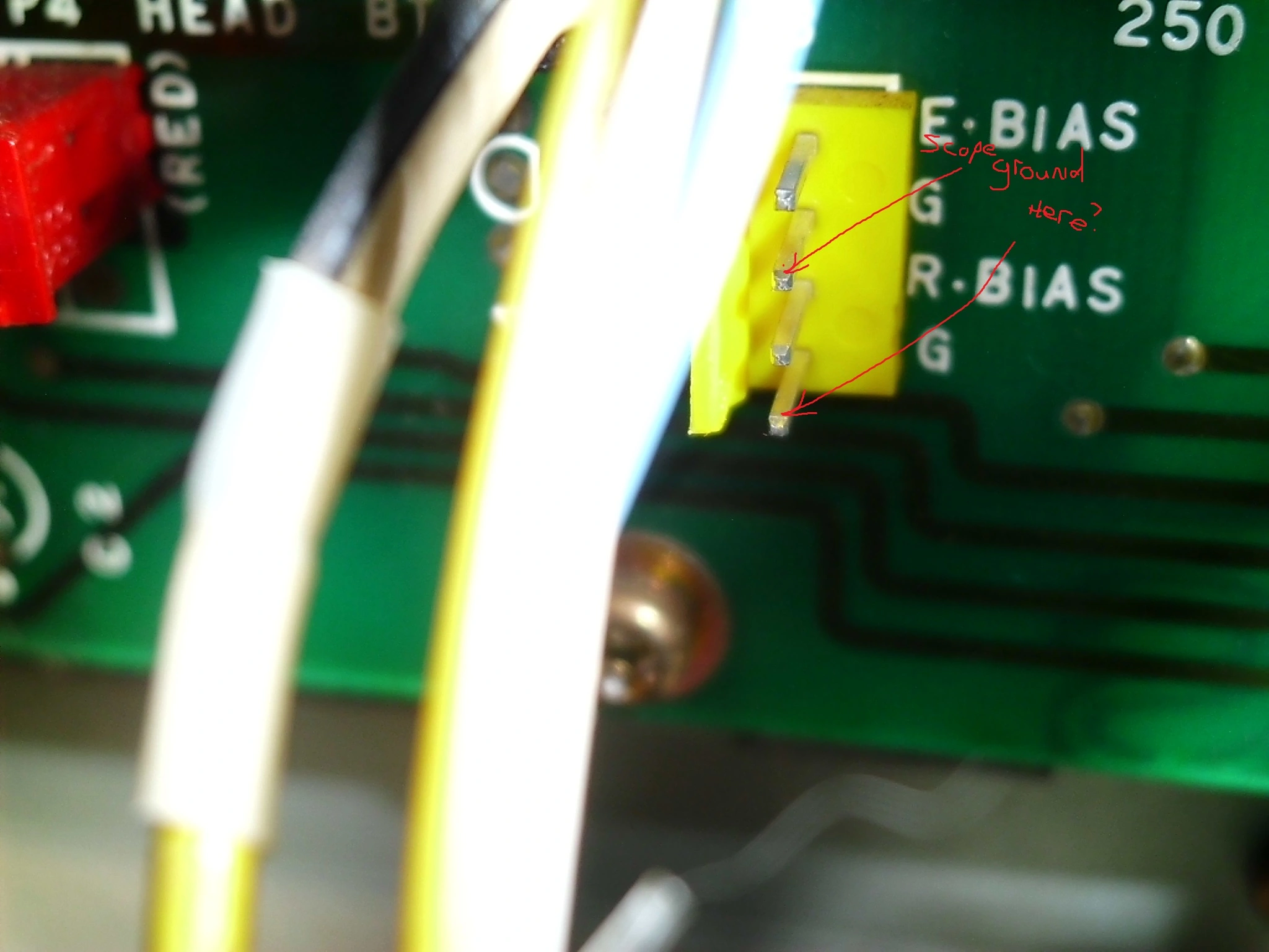

Recap; I've discovered my ATR60-16 will not erase any tracks.
It does Record all tracks.
All lights function correctly upon entering and exiting record function.
When inputing a signal from the console oscillator and the recorders input is set to Sync. Tracks 1-8 do not register on Recorders meters when Rec/Ready button is engaged. Tracks 9-16 DO! Is that right?
Any Help or advice greatly appreciated. As I don't have any Techs anywhere close. I'm left to my own on this.

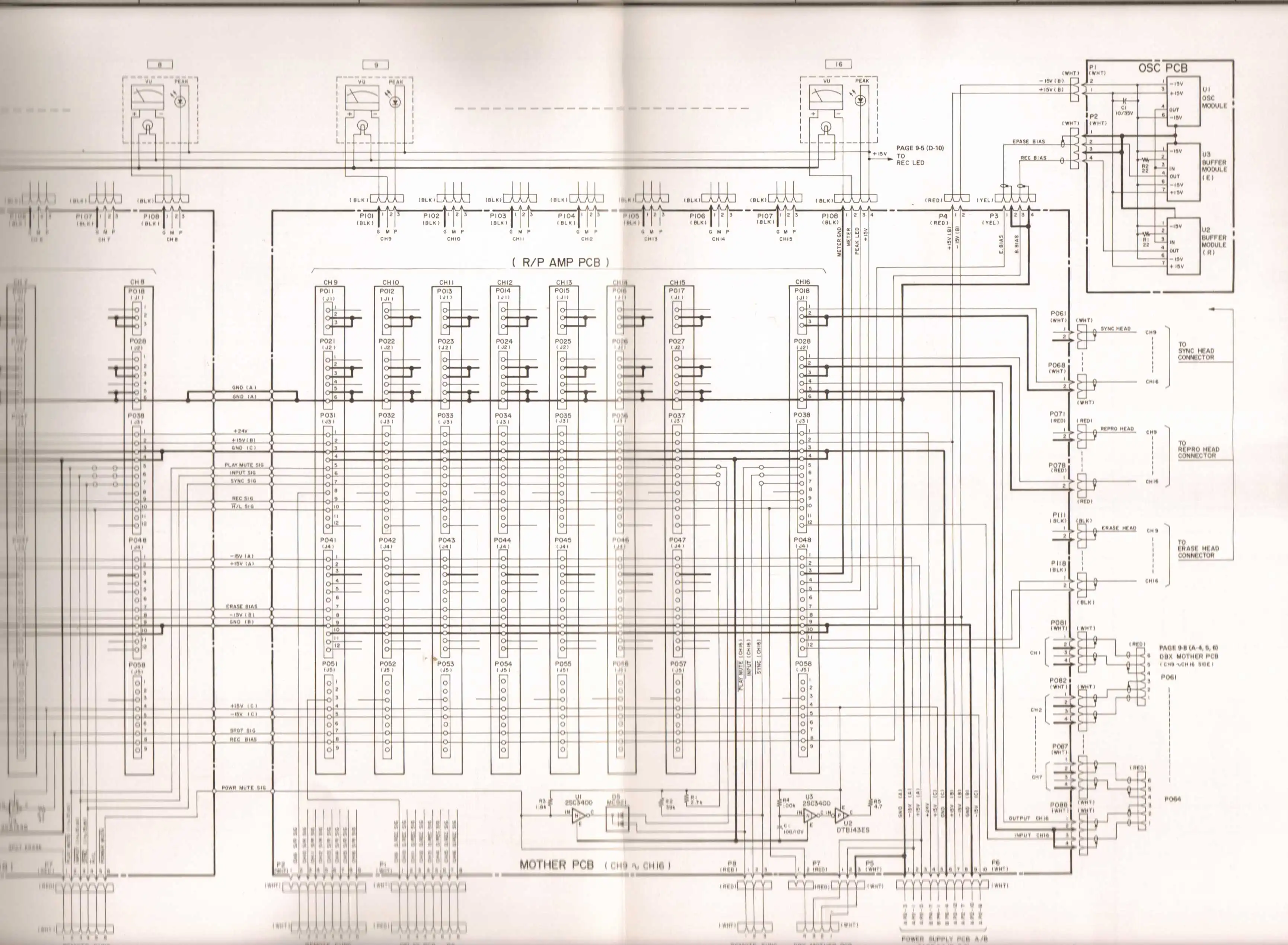

I studied the schematics and have found myself getting lost in the erase head trace that way.
