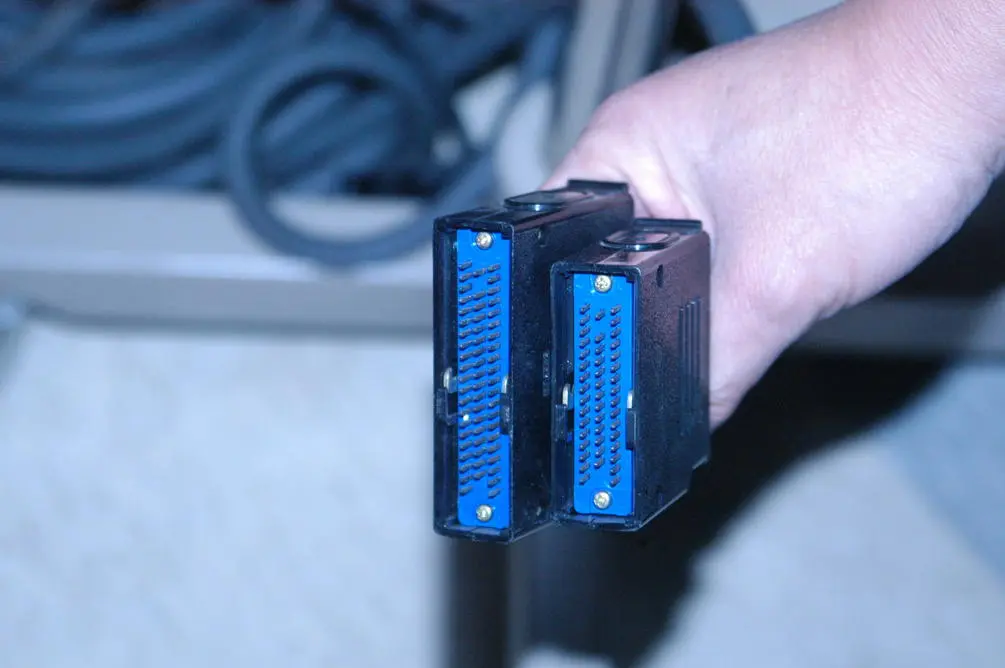

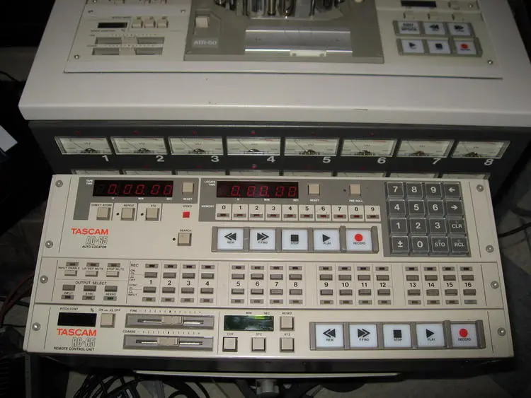

i want buy a TASCAM ATR-60/16 ,it's looks fine,
but have the wrong remote: RC-65 ,AQ-65,and the fucntion remote in a stand.i think it's for TASCAM MS 16 1'INCH.
plug the AQ-65 in and they work fine,so ,i think i don't need RC-65,but I DO need the fucntion remote!
the fucntion remote between TASCAM ATR-60 and TASCAM MS 16 i think is the same but different connectors.
here i put some picture.
can some one give a help?can I rig a convertor and connect the remote to ATR-60?

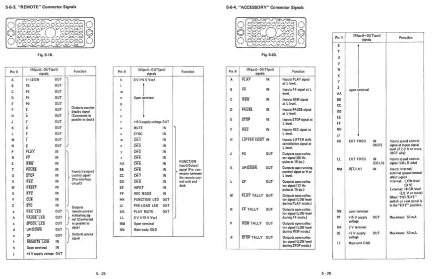

my friend who have a tascam 58 send me a manual.i can find the pin assginment info in that manual,58 pin assignments.webp
ATR 60 is more professional than 58,so i think it must be in some page.

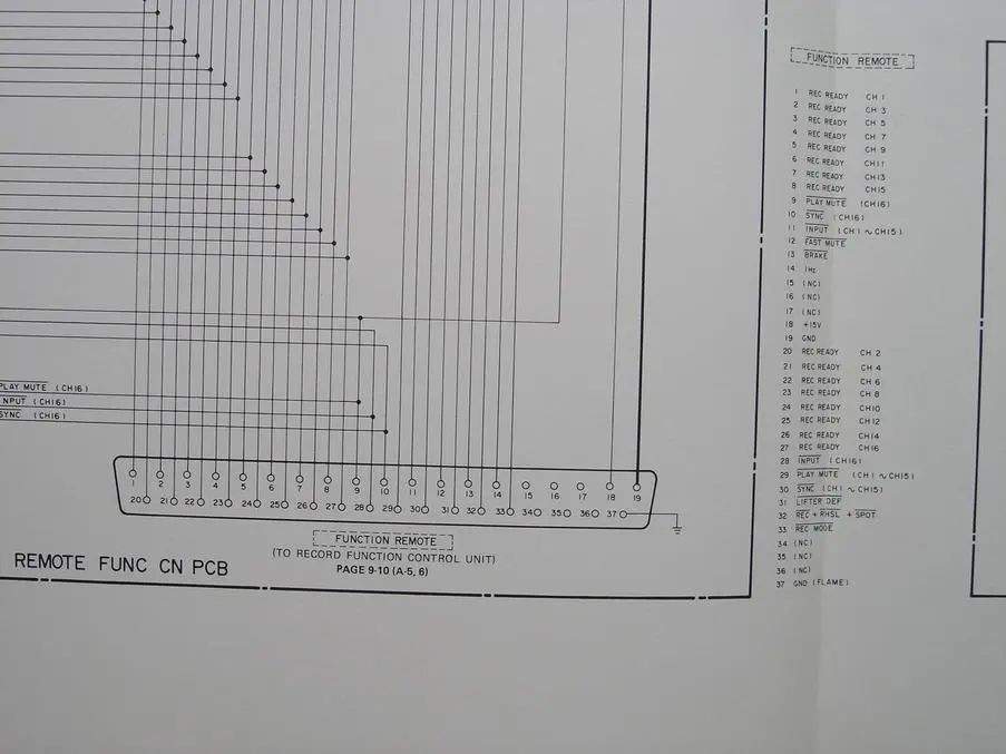

Zhou,

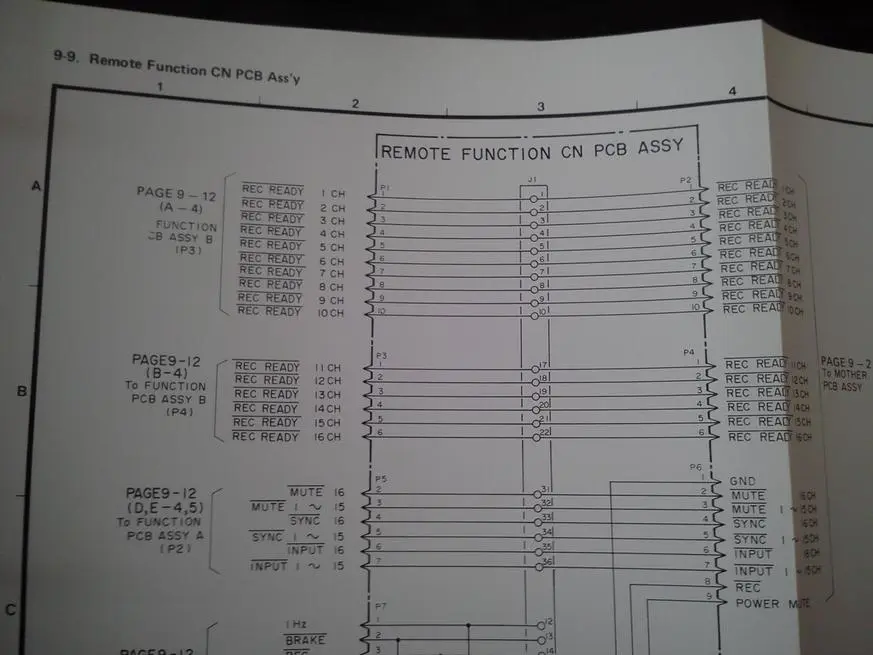

I'm sorry but the ATR-60 manual doesn't have a similar diagram for the Remote Function, although there is something for the Accessory Connector (AQ-65)....................BUT, there may be something to help you in the technical diagrams so I will attempt to take some detailed photos of the page in the manual and post them here in the next day or so.

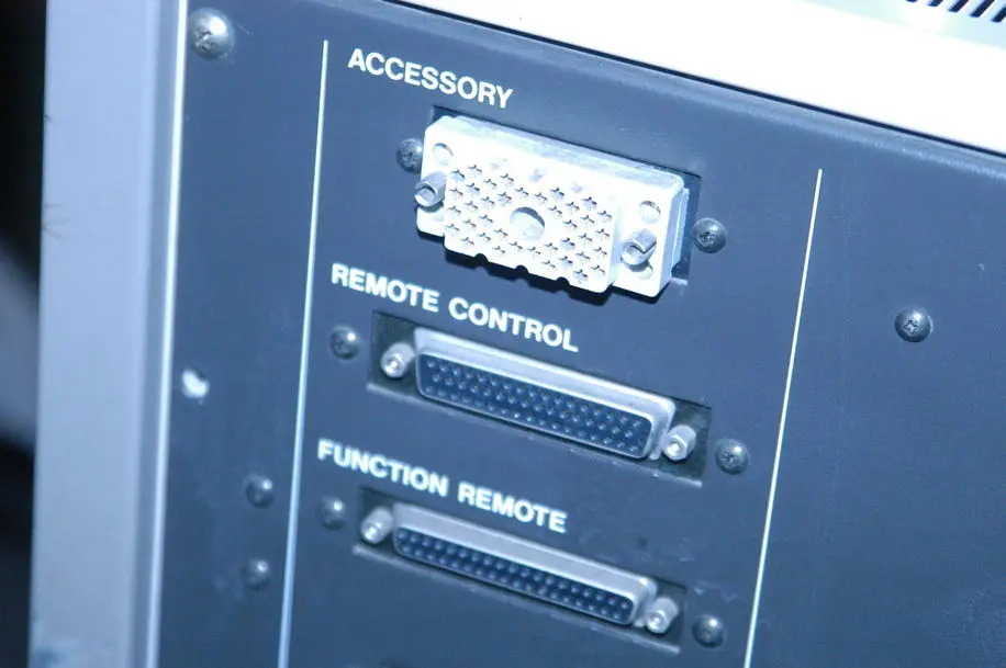

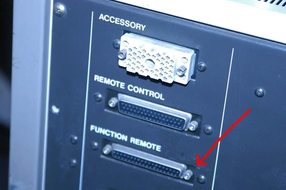

my only problem is RECORD FUNCTION REMOTE's connector.back of the atr 60!.webp
any info,like pinouts and schematics of this connector on the back of the ATR-60-16 will help a lot!
also the MS 16 info about the FUNCTION REMOTE...
thanks again!
View attachment 67471Zhou,
I think this is what you are wanting :)
If you need a better quality pic as well as a few other pics of the ATR diagrams PM me your email address and I'll get them to you.
I think you may be able to purchase a manual from Tascam.
:cool:
:)Aurock
YES!it's what i'm looking for.
and yes i need a better quality pic ,i'll PM you!
thanks form my heart...
this is ausrock send me the pin assign from ATR60/16's manual.
