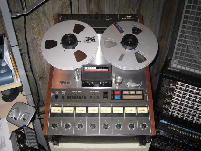

For the deck height adjustment if i adjust the right side (take up side) to the same height as the left side it should work with no rubbing right? Never would have looked behind the wood for that adjustment. I took the base plates off the reels and was looking for adjustments. Figured i would wait for the manual to see where the adjustment was.

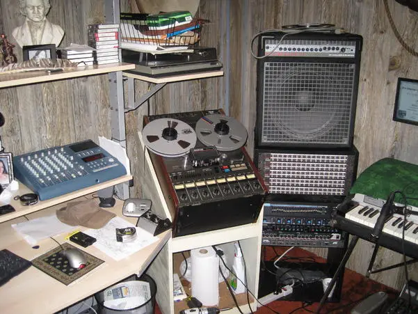

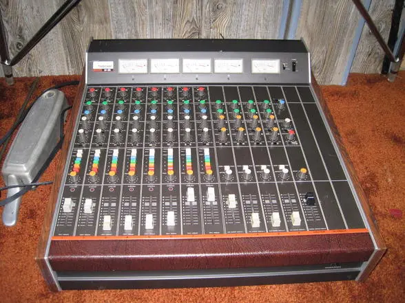

I have everything all over the place at the moment so please mind the photos. I'm playing equipment tetris with all the instruments/recording/amps/computer and what not.

Hey man, looks great.
No, unfortunately I sold my 80-8 and Model 5 to upgrade to a 16 Track setup.
I definitely have gear nostalgia for them though.
Anyways, I would put everything on the Patchbay.

Try the same height for each Reel table.
If it doesn't work re-adjust it.

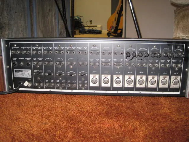

By the way, you are gonna need 3 jumper plugs on Channels 6-8 on your M-35.
The Channels WILL NOT WORK if they do not have them at the Access Send/Rcv jacks.
Try looking around Ebay for the jumpers. they pop up from time to time.
Maybe someone here has extras?

Yeah, the M35 is unique in many regards. Best to get a manual. I have one, they are good sounding boards.

As far as the take up reel, just loosen it by way explained above, probably a long allen wrench, and then eyeball it with tape on it, from that side so the tape lines up nicely with the heads and the other tape guides and then tighten the screw.

RCA patch cords (the shorter the better) will substitute for the send/rcv jumpers.
