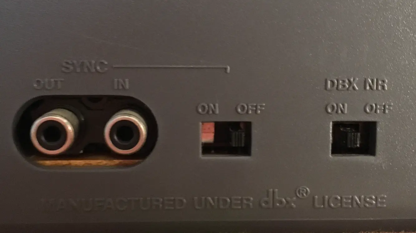

The pic I added shows the only options I have. I read a bunch of other people having problems losing tracks but none of them seemed the same as mine. I’ve flipped and cleaned the switches also.

Stupid question maybe but have you read the manual from end to end, especially the bit about the difference between CUE and MIX? CUE being what you hear through the headphones and MIX what comes out of the mix down. My 424 MKIII can do the same as you describe and it's just that I've got the routing wrong for what I'm trying to do. I had to read the whole manual and follow it step by step to get it. On the 488 manual page 7-8 and page 37 cover it.. TASCAM 488 PORTASTUDIO OWNER'S MANUAL Pdf Download.
Just a thought.
Thanks! I’ve been using this specific recorder for ten years and I always switch between cue and mix. Thank you for helping though.

The Tape Sync switch should be off.
The dbx switch is a global switch for all tracks, the Tape Sync switch defeats dbx on track 8 regardless of the position of the global dbx enable switch.
