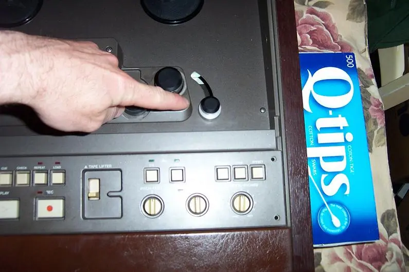

Thanks for the reply.Its the lifter on the left(if thats what you call it).Theres one on either side that travels through a slot.When I lightly push down or pull down on it it starts counting.Anyway to adjust this?
Did you mean "right lifter" when you said left?
What you are pointing to in the picture is the right tension arm. The bigger roller just to the left of that is the tach or counter roller. Does the counter roller spin free?
When you pull the right tension arm down (toward the front of the machine) what you are doing is increasing the tension on the tape. If the rubber is dry or glazed on the counter roller or the counter roller is not turning freely then you should address that first and then we can get into a simple and basic tension adjustment you can do on the 388.

Ok.Its the right tension arm.Got my lefts and rights backwards.
When I bought the 388 the guy who sold it to me showed me that when he put a little tension on the right tension arm,the counter would start.So I guess it would be a tension adjustment.The only thing is,I dont have any tape for this thing yet,so I guess I cant do an adjustment without it right?

HOW IS THERUBBER ON THE COUNTER ROLLER AND DOES IT TURN FREELY?
Sorry...not shouting, just trying to get your attention. You keep jumping ahead. No need to mess with the tensions I the counter roller doesn't even turn freely.
Alright.The rubber seems fine and I gave it a spin and it spins pretty smoothly.
