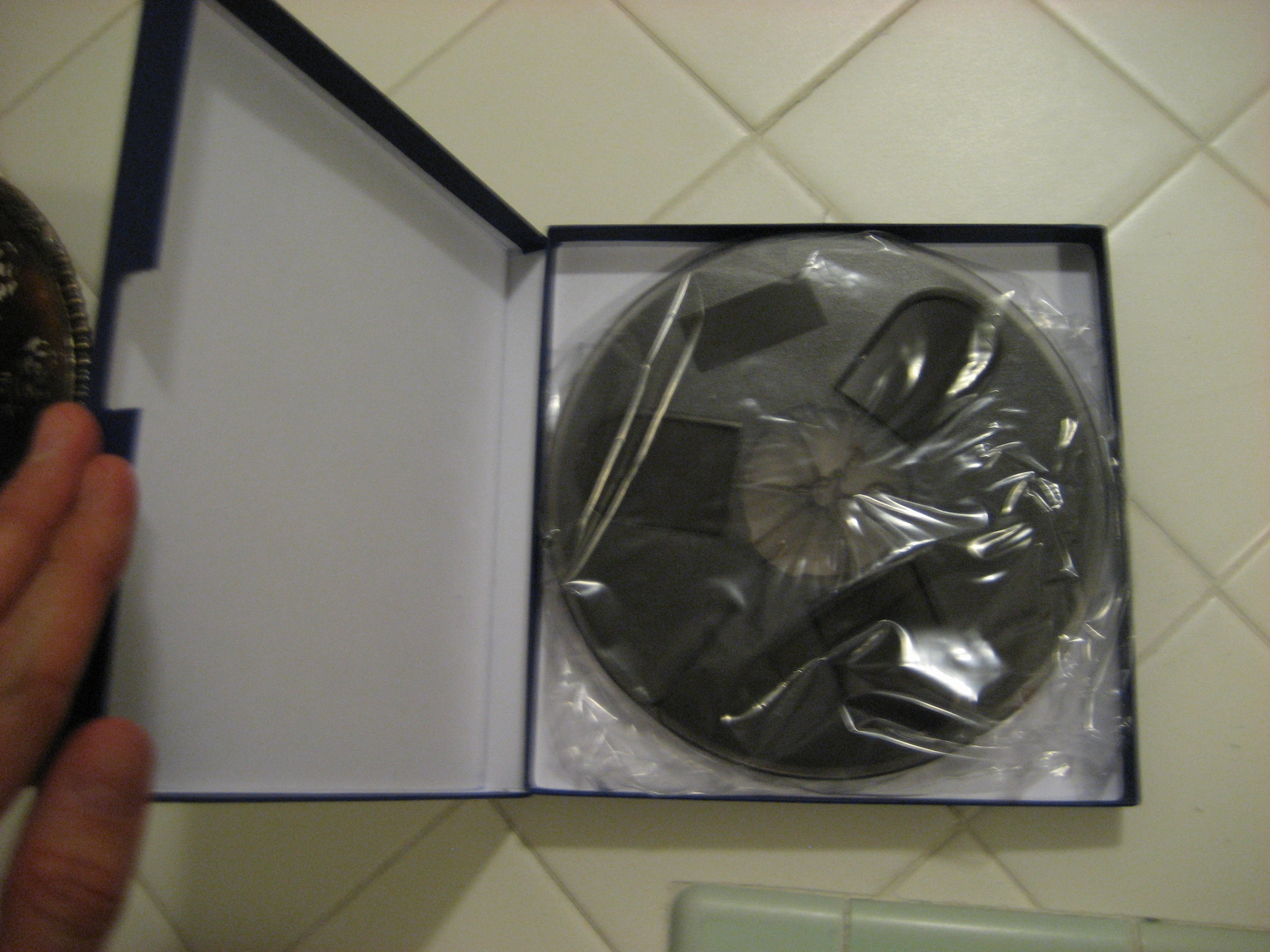

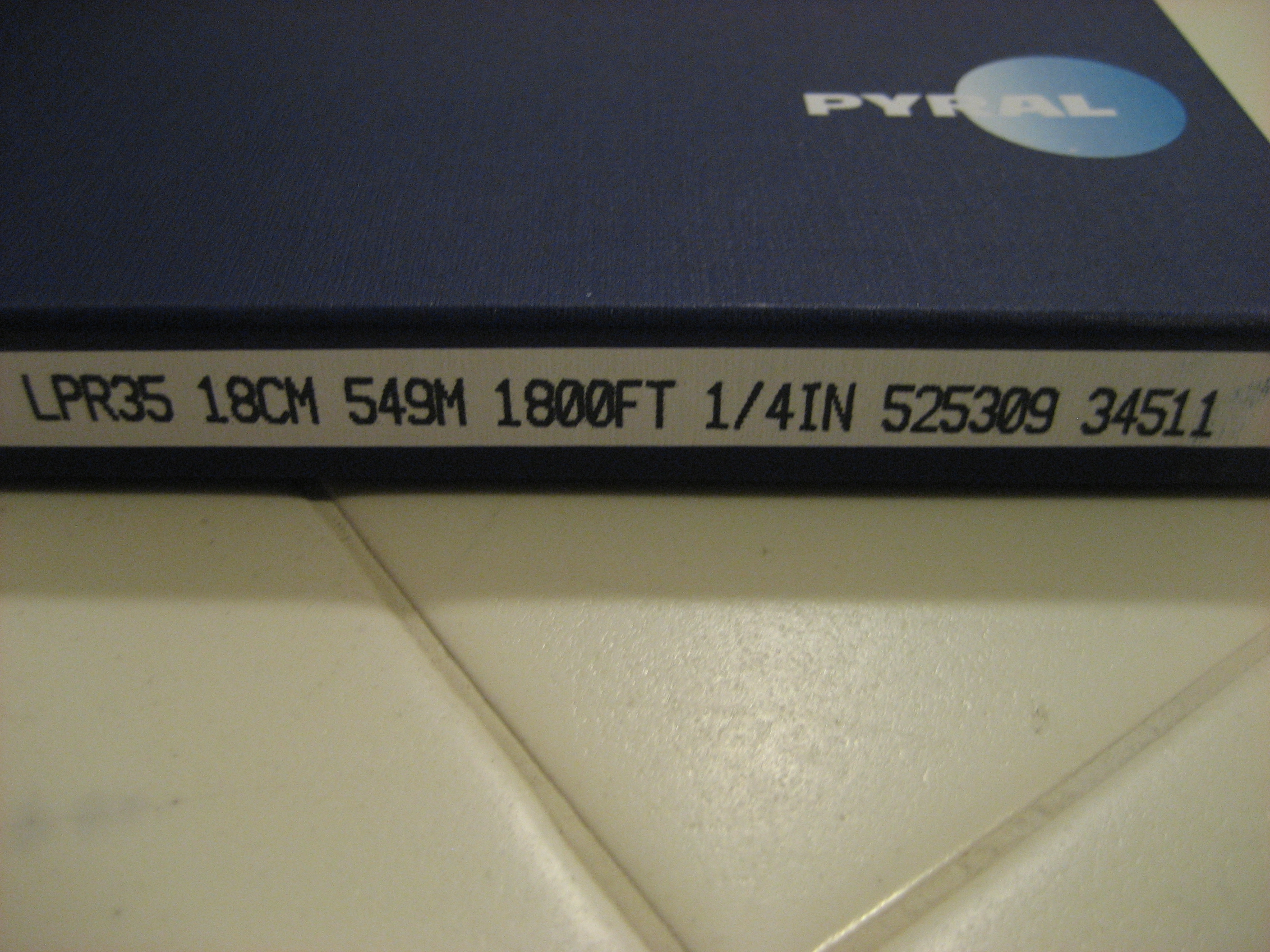

I've had no problems with country-laning on my 388 switching between tape brands. Like Cory said, it's wear related. If it affects your machine, it's not hard to diagnose. The tape will noticeably ride up and down the head and sound weird.
You could also just try the machine with the new tape. And if it sounds good, it is good! I love the 388 but it isn't a Studer A820.
