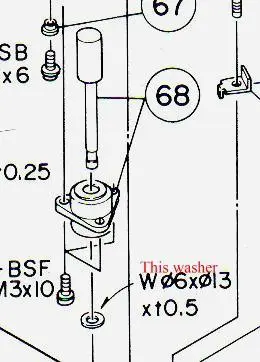

Isn't there a thrust bearing at the base of the capstan shaft? That thrust bearing is supposed to be adjusted so there is a specific amount of play. It sounds as though you may have too much play. There is a procedure in the service manual.

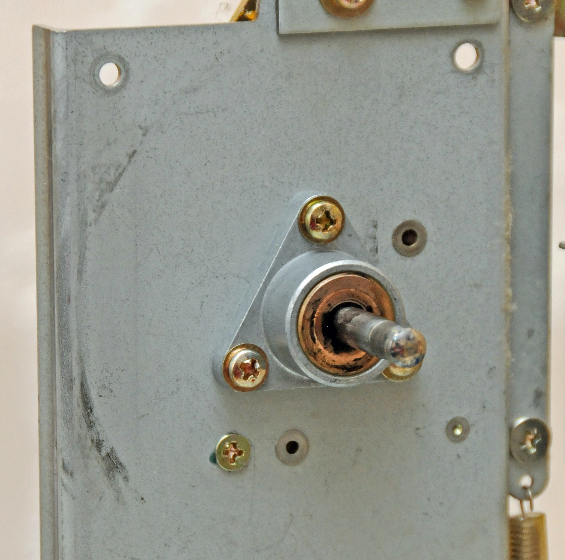

I had this problem with my Tascam 34. What is happening is that the flywheel is scraping on the underside of the base plate the capstan bearing is mounted on.
See my thread over on tapeheads; Tascam 34 Flywheel problem - Tapeheads Tape, Audio and Music Forums
What will have happened is, inside the flywheel at the bottom of the capstan shaft, is a metal washer with rubber bonded to it. This acts as a buffer to keep the flywheel away from the plate. The rubber will probably have turned to goo.
I cured my 34 by using an M6 x 6mm nylon spacer in place of the rubber.
After replacing the flywheel on the capstan in the same position that it was before removal, I did not find in necessary to make any further adjustment to the thrust bearing spacing.

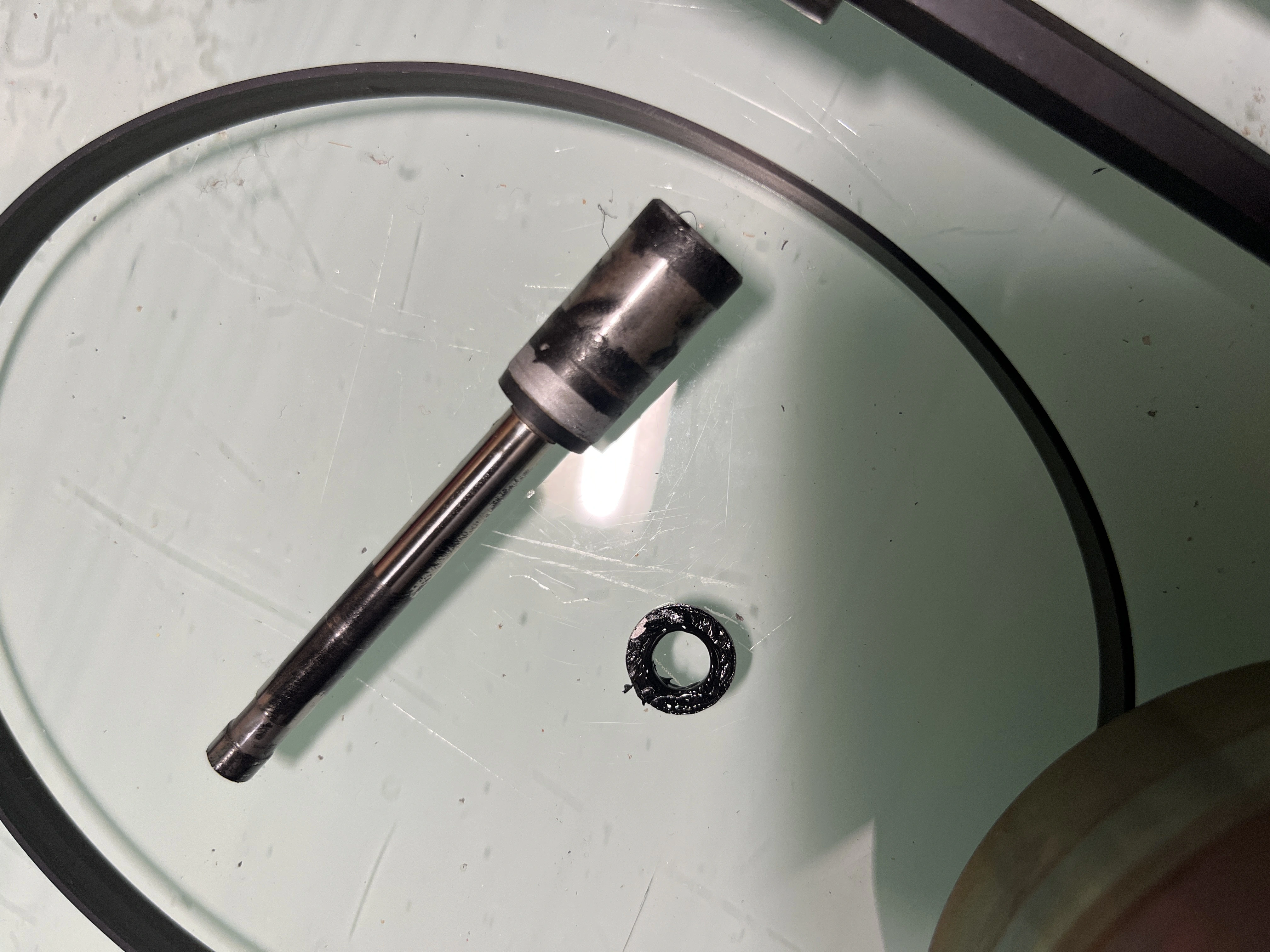

Hi, saw this thread and the issue described here is exactly what I’ve been experiencing with a newly acquired 38. Thank you! The internet is amazing. The capstan was working perfectly when I got it, but after a couple of days of use, I noticed it started to come forward when the machine was upright and started rubbing. It also has accumulated a fair amount of horrible black goo around it.

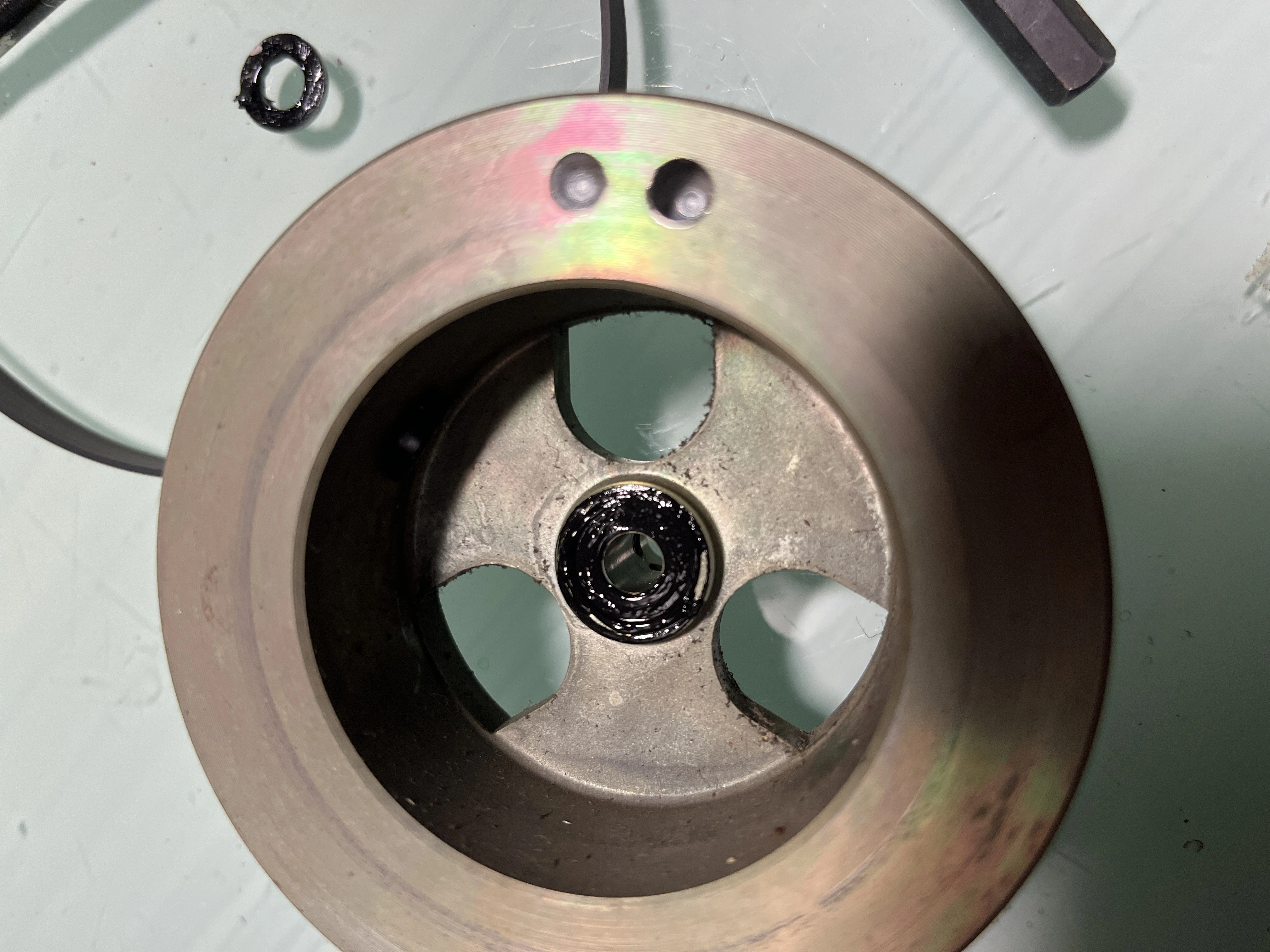

Following the notes in this thread I removed the capstan to access the underside and indeed I see that the black rubber spacer has completely melted. But I’m wondering if there is supposed to be grease here as well? Or is everything on the capstan shaft just goo from the rubber spacer? Going to replace with a more sturdy one as recommended above but wanted to make sure if it needs grease I add that before I put it back together. I just can’t tell because the goo looks like grease and has filled the shaft and area around the bottom of the flywheel.
Should also say the belt in this machine is in good condition, recently replaced and clean so the goo is not coming from there. Attaching photos of the dreaded goo.
Thanks!
Roland
I would say the goo is a mix of grease and ground up rubber. Once cleaned up try the shaft on the bushing and check for 'slap'. I have no idea what the tolerances are but I would expect barely any movement? (the capstan on my A3440 has just a suggestion of movement cold) if it wobbles maybe a local engineer can turn you up a new bushing?

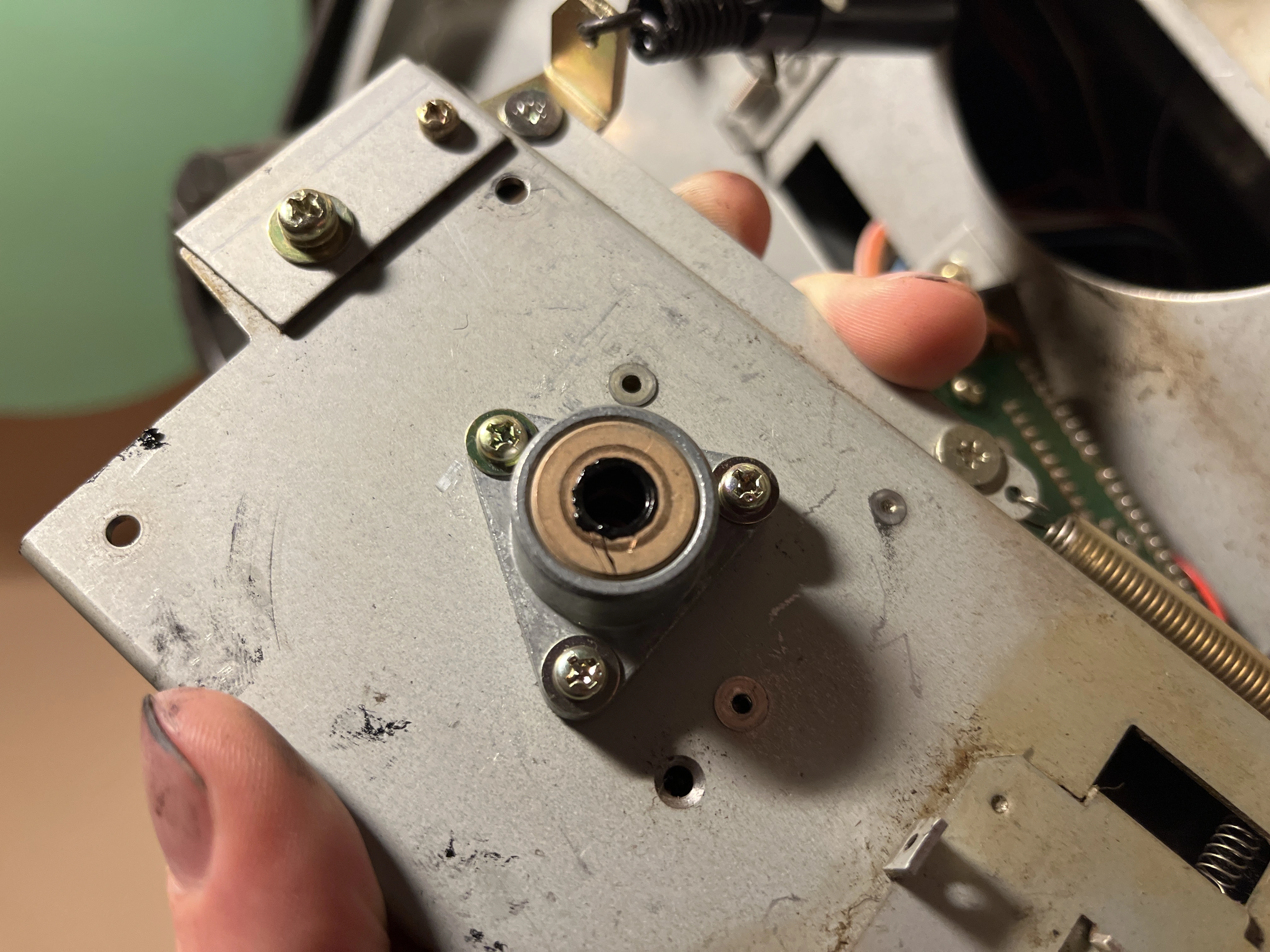

I found this discussion while searching online. I think I have the same issue with my '84 Tascam 22-2. It was playing ok the other night for several hours, after not being in use for some time, but then it started to make a chattering noise, which goes away when I tilt the machine back, but is constant when upright.
In the 20 series the capstan bearing is oil-impregnated bronze. There is a thrust bearing at the rear of the assembly which has an adjustment. My recommendation is to remove the shaft from the bearing assembly, clean both thoroughly, lubricate, and check the thrust adjustment per the service manual.
