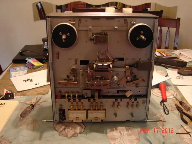

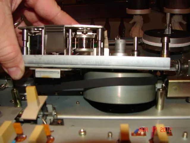

Here are some random photos of the process.

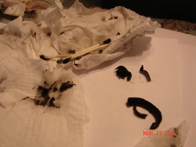

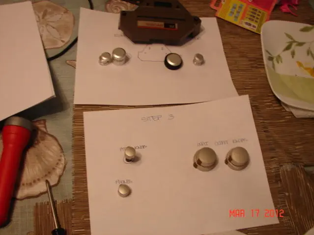

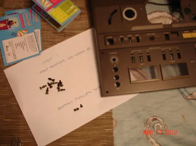

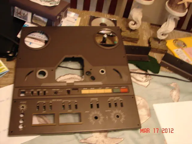

And the last three pics. The last one shows the remnants of the old belt and the crap I cleaned off of the capstan.
