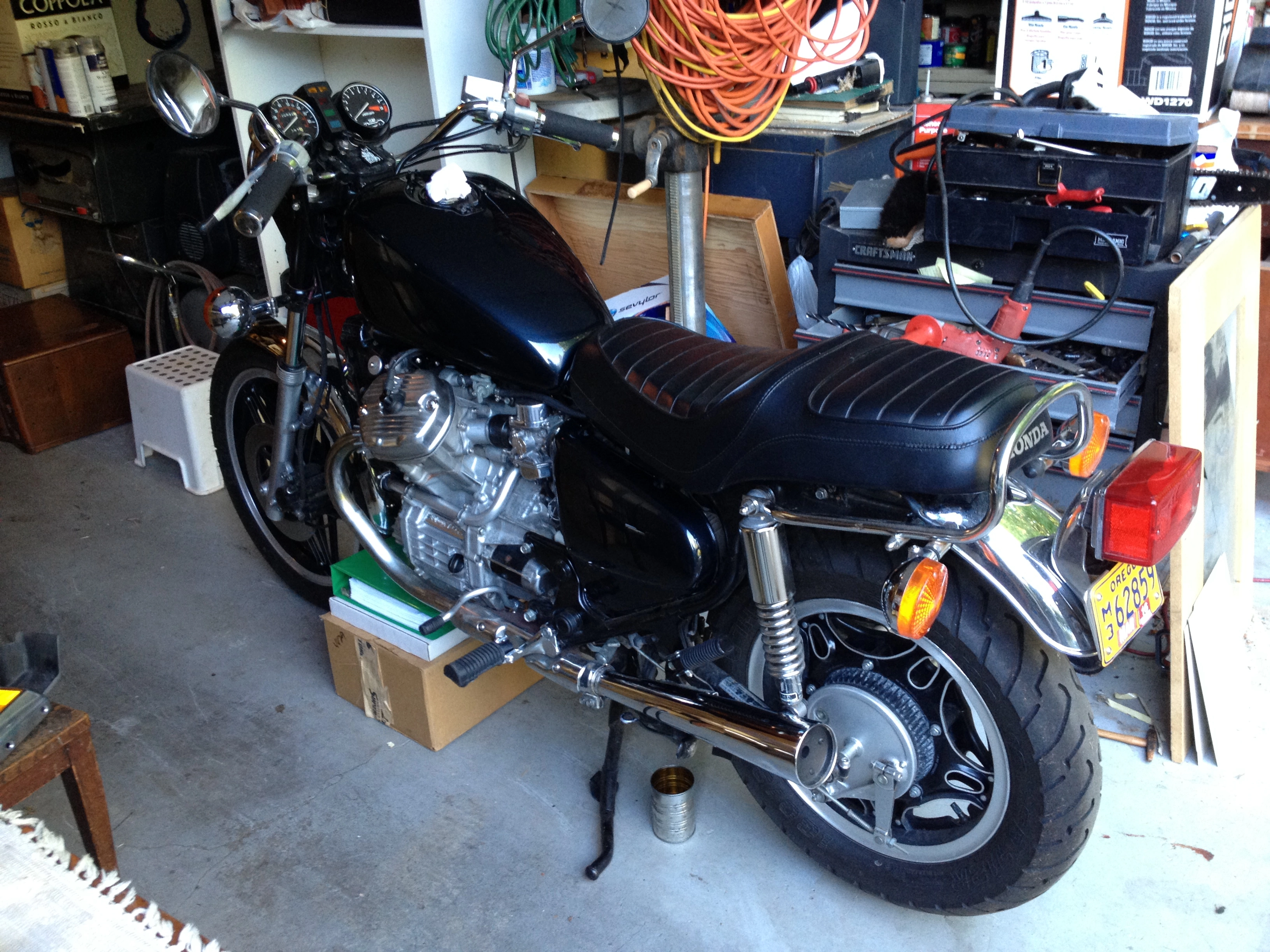

"Rufus"...almost done...

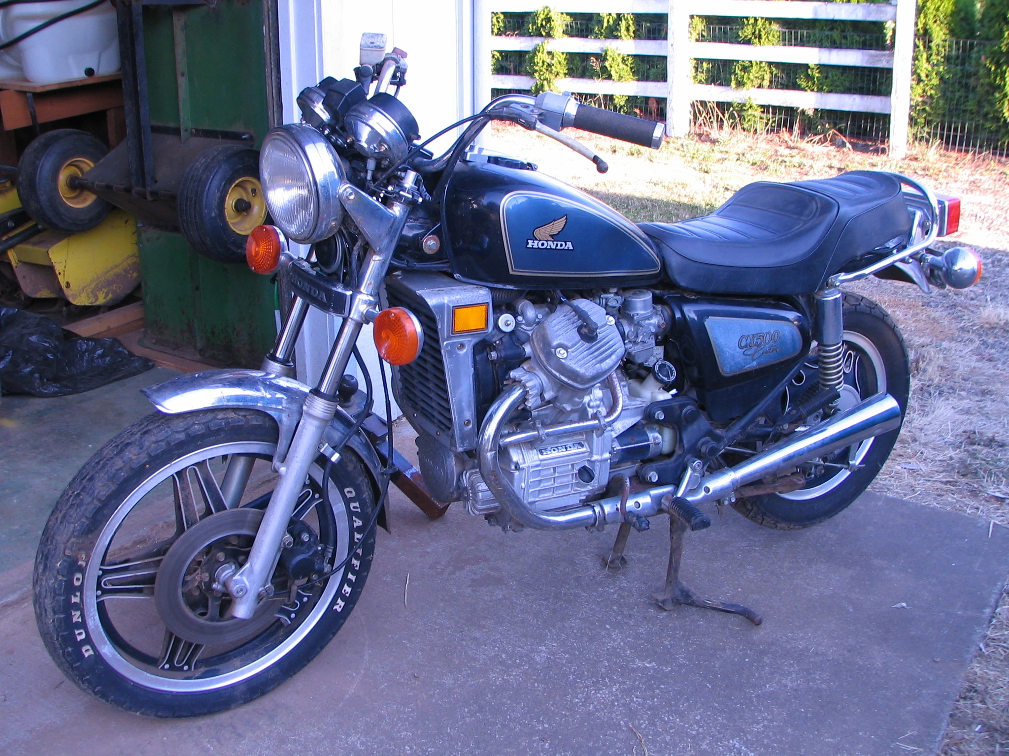

This is a sample of the "before" state...15 years dead in a barn he was...
Sorry...that was a total hijack...I guess the gauges on the bike are analog though... :D
