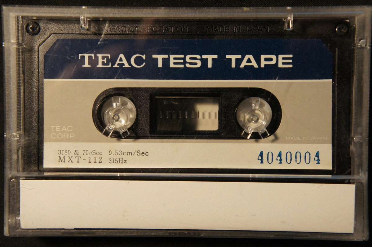

I have this problem with my 244. How do you calibrate it to sort it out?
You'd need a standard calibration tape, which is expensive and hard to find. You'd also need a reliable signal generator and a DVM. You'd need a service manual and plenty of hours to learn the ropes and dial it in correctly.
Alt., you can find a qualified tech that you trust. Personally, I'd only trust TEAC Service in Montebello, CA, and there is another known "old timer" in a different part of LA who does this stuff. Qualified techs who know anything about analog are a rare breed, but you may get lucky and/or put some investment in tools and time to DIY.
I'd recommend the TEAC MXT-116, multifrequency test/alignment cassette for the 244 (runs @ 9.5 cm/s... 3-3/4 ips). Costs a pretty penny if you could find one new (call TEAC Parts for info), or less money for a used tape off eBay.
There are several different but similar TEAC test tapes, at different speeds & for difference purposes, so scrutinize listings and model numbers carefully.
