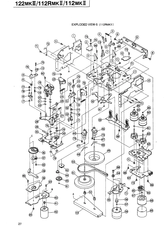

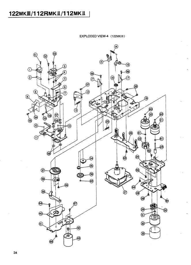

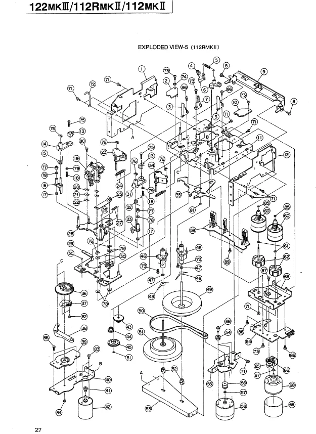

Hi, after a few years there's another newbie who will probably face this problem again.
I'm about to get one of these decks in the upcoming days, and it has the same high pitch playback on the start, then goes back to normal. The deck was repaired by a well-trained technician, but he didn't have luck to point the root of this problem.
He even replaced the whole mechanism, changed the belts to new ones, but the problem stays. Probably he just forgot something or what you find out.
Can you show somehow where should we search for the problem on the exploded wiew or where should we start to look after this problem?
Thank you for your help in advance!
