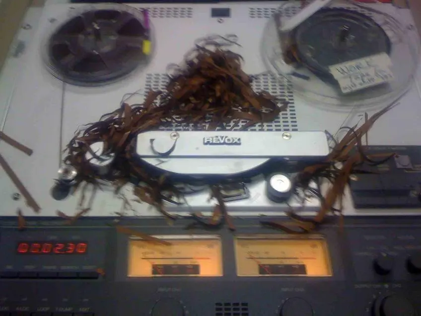

The 407 will depend on the year it was made. A test may show no problems, but if the 407 you have was made before late 1994 it will eventually succumb to sticky-shed to some degree... the severity ranges from a loss of high frequency capacity to falling apart all over your machine. Only way to know for sure is to check the date code on the edge of the box. Another way to get a less than 100% idea of what you have is to recognize the differences in box style from different eras.
Post the date code from the white label and/or post a pic of the front of the 407 box and we can tell you. Are they all the same style box?

Here's what happened when I threaded the "NOS" Ampex 407 onto a REVOX C-270. I pressed play and 2 1/2 minutes later, what a mess.
