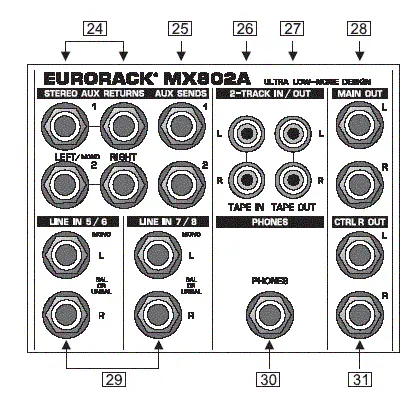

here is a pic of my outputs attached...
ok i just looked at the pic...do keyboard audio out to stereo aux return 1.....then main out (or tape out) to your computer's sound card line in..monitors to computers speaker out.
